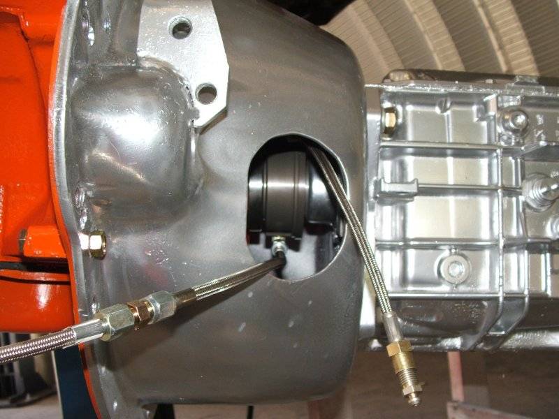

Yes I do use the hydraulic clutches if the cars started out as automatics--but my 426 Max Wedge was a 4-speed from the factory so I retained the factory linkage to apply the throw out brg--its only slightly stiffer than the hydraulic actuated TOBrgs and not at all objectionable-so its a matter of choice as to which you use--if using a hydraulic unit be sure the throw out brg has a limiter so you dont push the piston out and loose all the fluid and then you have to pull it all apart to put the throw out brg back together. When I did my 1st conversion there were NO kits and it was a learning curve--most units have delt with that issue and shouldnt be a factor--BUT LOOK and be sure --a few pictures of TKO-600 5-speed over drives I use
