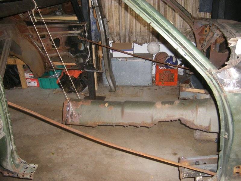

So here is the story of my '69 Road Runner. I got this car when I was 15 out of Southwest Wisconsin. I purchased it off of Ebay and the pictures did not do it justice.....for how rusty it was. Once off the trailer, my dad and I got it running and into their garage. Fast forward 19 years and the car is painted and I'm starting to get moving on it. When people say a Mopar had a "frame off" restoration I usually laugh, but in my case that is fairly true. At certain times I had a sawzall in my hands and thought about cutting it up for scrap after hitting issue after issue. 3 of the 4 frame rails, rockers, quarters, all floors, etc have been replaced along with numerous patches throughout the body. All metal and paint work was performed by myself and my dad.

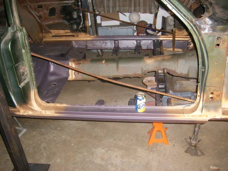

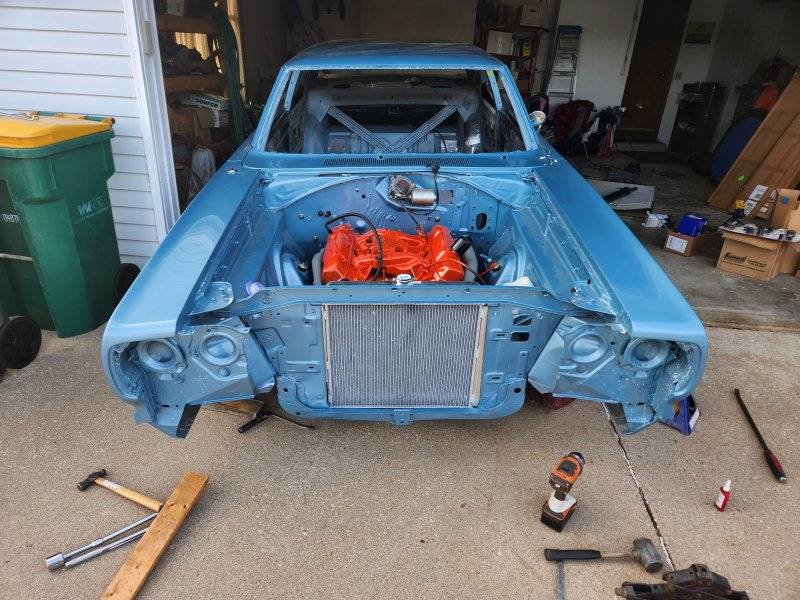

Attached are some pictures of its progression. I was lucky to have a friend with a donor Charger where I was able to put the rockers, rear floor pans, and frame rails from the Charger in all at once, which helped with alignment. The picture of the car on "stilts" next to my Dad's '69 GTX is prior to going to the frame shop, where everything checked out great. The second to last picture is as it sits now, painted and ready to be completed! Realistically if I can complete it in the next 2-3 years I will be happy!

Lots of work for sure, but it really turned out nice. I like B3 blue, not that common of a color. You probably already knew this, but I will mention it anyway just in case. If you took the entire rear portion of a Charger and put it in your car. Dodge has a 1 inch longer wheelbase than a Plymouth. They accomplished that with the leaf spring hangers. The fronts are just bolt on, but the rears are welded in. Ask me how I found out about that......

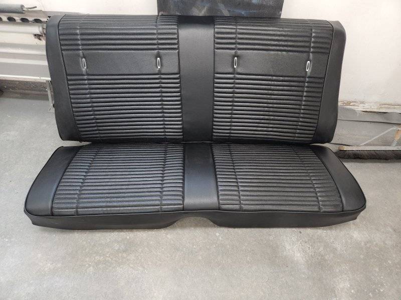

Some minor progress this weekend. I re-covered the rear seat and also installed some sound deadening to the car (fat mat). It also sounds like I have a deal on a running '69 440 out of a '68 GTX. The owner rebuilt a '68 440 for the X which is how it has become available. I need to help pull that out, but that will help speed things up!

Nice to see seat medallions - most guys either don't know or don't bother with them.

Was able to go through the engine and replace seals, timing chain, etc and have it painted. Will look to drop it in the car in the next few weeks. The best part is I now have access to a 3 car garage 5 minutes from my house. Previously I was making a hour round trip commute to work on it, so having it closer should increase the time I get to spend wrenching on it.

Was able to drop the 440 in yesterday. Along with that, got the driveshaft hooked up so the whole drivetrain is in. Got a few other odds and ends installed. Next up will be the fuel system, brakes, and finishing up some minor suspension odds and ends.
