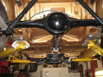

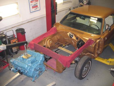

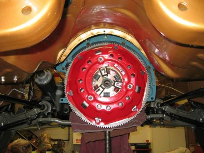

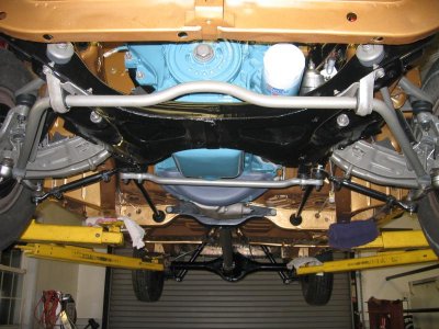

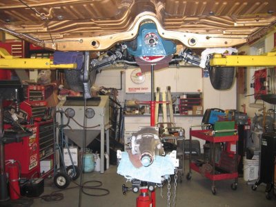

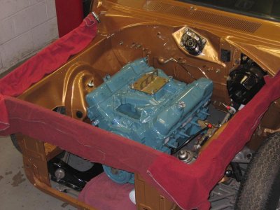

Yesterday was the day!!She's Been waiting along time for a heart transplant.Started out on Sunday by cleaning up the operating room and organizing parts and bolts. Motor slid in easily without issue. I used a 2x4 across the torsion bars to take the weight of the engine at the rear. Put a couple of long grade 8 bolts through the lower bellhousing holes to catch the wood. Installed a new Mc Leod clutch on the original, resurfaced flywheel , bellhousing, and clutch cross shaft with new seals and bushings, all from below , while on lift. The thick paint at the bellhousing hole gave me a little trouble getting the transmission to mate the housing. Should have thought of that earlier. LOL. Got crossmember installed , and driveshaft. Filled Trans and Diff with gear oil. Will install a few minor parts from below this morning before I move it back to the upper bay. Will need the lift tomorrow for another job. hopefully will get rest of under hood stuff done in the next week or so I can hang the front sheetmetal on the car.

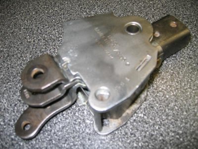

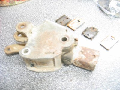

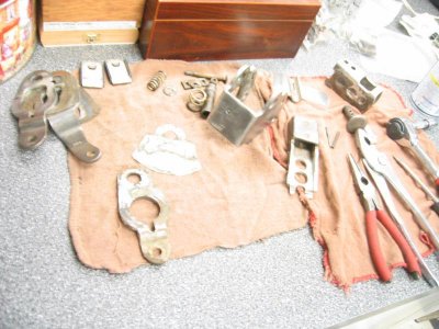

Firstoff , sorry for the poor pics. Must be sumpin wrong with the camera. Been too busy lately to work on the car, but I did rebuild the original shifter this week and installed the left exhaust manifold. Gonna try a get the rest of the under hood stuff installed this week. I will post pics as that goes.
That shifter looks good. Heck, what am i thinking. Everything you're doing is looking good.
