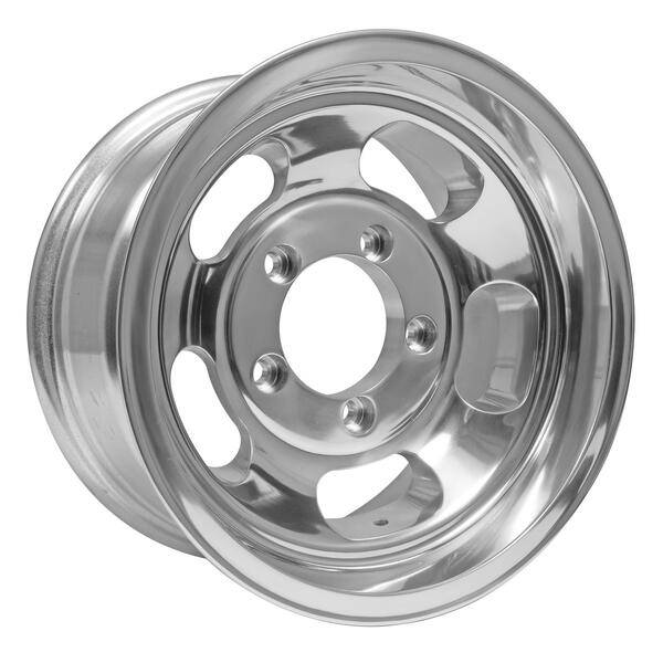

Can I fit 15x10 rear wheels on my '76 Charger?
I'm looking at a set with a 3.25 back space, which may not be enough without going super-high on the stance. Also considering leaf spring relocation, but right now wondering if I should grab the wheels or not.

Those will not make outer clearance unless you plan to put the back end of the car in the sky.
As far as measuring goes, measure rim off an existing rim and tire. The you can figure your max wheel., tire, and needed back space. No need to spend $70.

A ten inch wheel is really eleven inches wide, at least the aluminum ones are, as a wheel width is measured from inside bead to bead. So to have the wheel exactly centered, bs would have to be 5 1/2. Then you have to add the section width bulge for a tire with a nine to eleven inch tread, say a minimum of twelve inches, maybe more. The wheel you are looking at moves that tire 2 1/4 inches closer to the fender than a neutral.

I think that on standard rims that is basically true, however, My old 8.5" aluminum slots are definitely 3 1/2" back space as were the 15x10 steel cyclones that were on my car when I bought it. Also, I bought a pair of used 15x10 aluminum (used) Ansen Sprints on Ebay and they also were 3 1/2" backspace! However, my 15 x 7 front Ansen Sprints are 4" back space. There are many available back space options these days, especially in 16",17", & 18". My factory 15 x 8" police wheels were 4 1/2" backspace.
Agree, i have a couple pairs, maybe three pairs of old 8, 8 1/2 one piece mags (amercan racing daisies, and a pair of ansen five spokes) that have 3 1/4,3 1/2 bs. They are the "deep dish" that look good, but only fit cars with completely open rear wheelwells. They wont fit 66/67 b-bodys, or 55/57 chevies for example.
They probably would fit the op's car, a lot better than tens would.
As I say there are many backspace options in aftermarket wheels. For this style of wheel I just saw 4" & 4 1/2" as well. Generally speaking I think manufactures pretty much make the offset for more specialized fitment which also may be due to lug pattern. This same wheel is available many different ways. At one time , you could get really deep dish wheels and even now, I have seen they sell these and similar wheels as blanks, they drill them in what ever bot pattern you desire. The 17"x9" wheels on my truck are available with positive, negative & neutral,(no offset).

Nice wheel for a mid-fifties ford pickup. Wrong bolt pattern for a mopar.
It is also the lug pattern on my 2000 Dodge Ram Pickup and believe me I would have gotten a set if I had the money,,,,,,,,,,however,,,,, With the newer huge brakes on vehicles today, like my truck, 15 inch rims generally won't clear the calipers. Thank God they make them in 17" now as well, so, when I possibly rob a bank in the future, I will finally get a set. By the way, I am several other sites as well and on the DodgeRam Forum, I posted a question on the 2 gen truck thread. "Does anyone here have or know of someone who has aluminum slotted mags on their truck?" Guess what, NONE! I think I will start a go-fund page so I can fulfill my dream and be Totally Unique!
