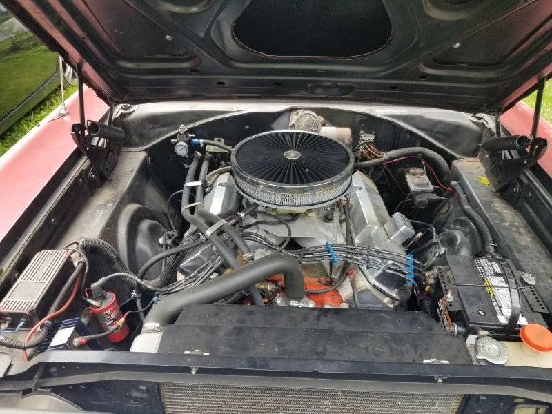

The car is a 66 Coronet 500. Originally a 318 auto, it's been powered by a refreshed 71 440 HP since 94. Edelbrock heads, unknown cam although I believe it's one of the mild direct connection hydraulics. Fuel comes courtesy of a FiTech Easy Street 600... don't hate :p, its performed flawlessly since install. Shifting duties handled by a nicely built 727 and sb converter. Outback is a 3.91 suregrip 8 3/4.
Joe, the former owner, maintained the car mechanically but had no interest in anything more than getting it safely to the track and back... leaving me with a TON of small projects.

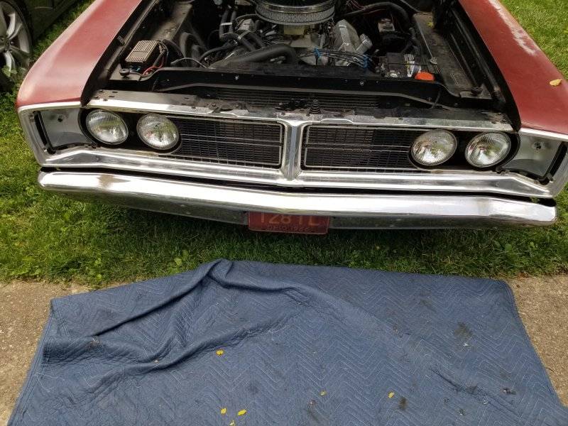

I know everyone will be shocked to learn 59 years of service isnt kind to wiring. Rather than tearing the car apart immediately to clean up every connection, I'm starting with LEDs for the running/turns and relaying the headlights. Plus repainting the turn buckets which have lost 90% of the original reflective finish.

I succeeded in getting the tails and turns fitted with LED lighting... OMG it can be seen! Along the way I finally replaced the high beams with Halogens... yes, the Nasty Net' was still sporting old school pre halogen sealed beams, functional even... not that they did anything useful. Now I can see as well.

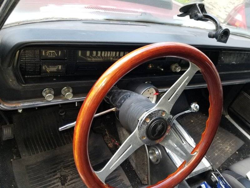

Gage cluster is in pieces. All the gages are now clean and working and led lighting installed. The hold up on reinstall is getting the the bezel and lens painted and polished. It must be done. The old flaking paint and chrome makes it look like I was transporting goth strippers. Black and silver glitter bomb.

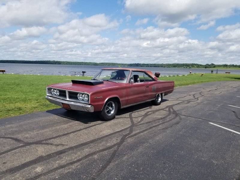

A pic from CJ Brown Reservoir.

Gage cluster reinstalled. Minor hiccup with no cluster lights. Experience saves the day and I discovered the issue by testing before final install.
Tip... it's very easy to pull the headlight switch without the cluster installed. Sure enough the rheostat winding was buggered up. No switch avail local so I made a slight mod eliminating the rheostat. Works great and the lights aren't too bright. Blacked out bezel turned out better than expected. Not perfect but close enough for my requirements. Best of all... working turn indicators. Now I can avoid running out of blinker fluid.

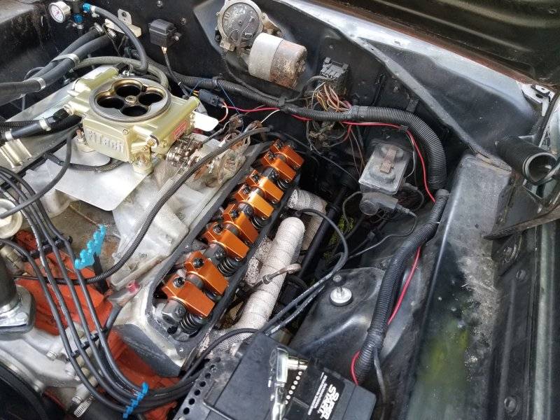

Spent a fair portion of yesterday working on the "Net". First up, adjusting valve lash. Easy peasy... unless someone flippin glued both faces of a composite cover gasket to the covers and heads. It literally took twice as long to clean up that mess than it did to set the valves. Then it was on to interior work.
