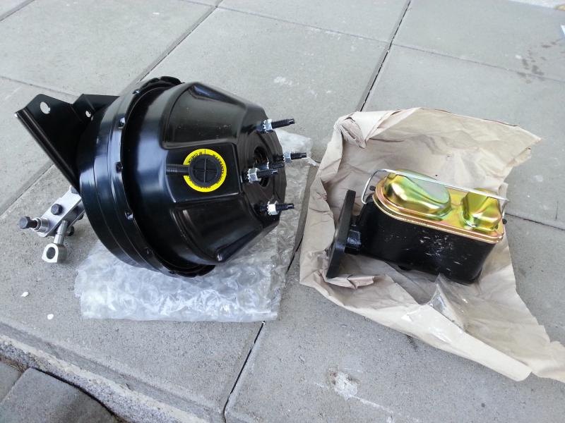

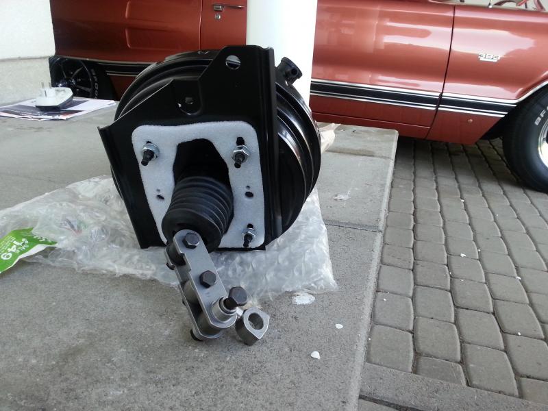

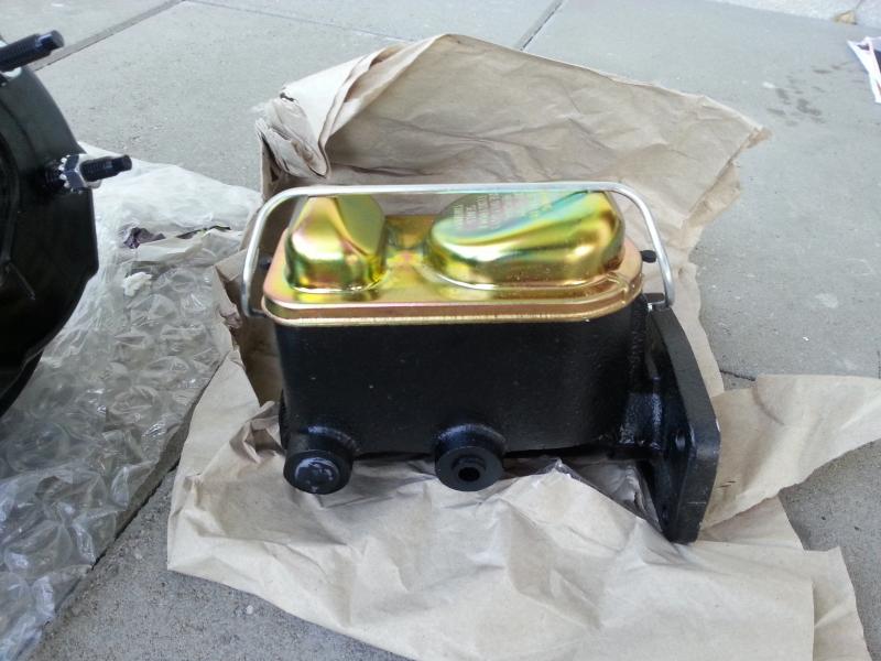

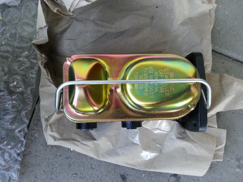

I just received my Booster and Master Cylinder from Wayne 'The Ram Man'..
I have not installed these yet. I have to wait for my mates garage to be free, so I hope to have these on my car in the next week or so. I simply do not have the tools or space to do this at home unfortunately.
But for starters here are the photos I took tonight with my phone instead of my Canon DSLR. So forgive me since the quality is not up to my normal standards..

That sure is beautiful, hope the install goes smoothly.
I wish my camera took pics as good as your phone does lol
I've watched several of Wayne's youtube videos and he knows his stuff!

I have now spent a lot of time looking at this booster and master cyl. I would dare anyone to tell this from factory original. Of course the giveaway is that it looks brand new, but the work is awesome.
I read in some papers that came with my gear that Wayne thanks some 'rich' mopar fan that paid for the tooling up for this stuff. That was the problem prior to this being available, the tooling costs were simply too high. But it seems that Wayne found a fellow mopar benefactor that made this all possible.

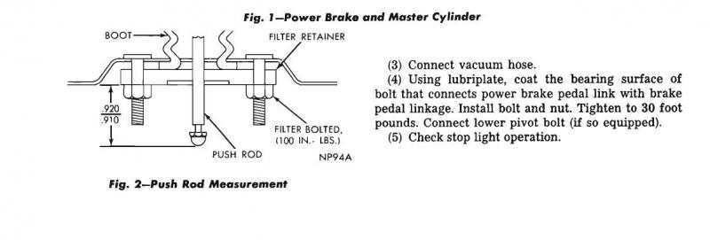

Wayne is a real good cat. Also spent a good 20-30 minutes on the horn with the guy, trying to figure out what exactly I needed for my power Bendix braking system. Heck, I didn't even buy anything from him and he still took the time to explain the system/parts. Looks like a pretty nice set up you got there Tek. Should work good. Be sure to check the pre-gap on the adjusting nut of the push rod, from the booster to the master. I'm guessing wayne might already have it set up, but it's worth a look vs. sloppy pedal play or brakes locking up.
Here's a measurement of the push rod distance, out of the FSM Tek:

That's very helpful mate. Thanks for posting this. It sure helps to have this type of info PRIOR to fitting. Saves a lot of heartache..
