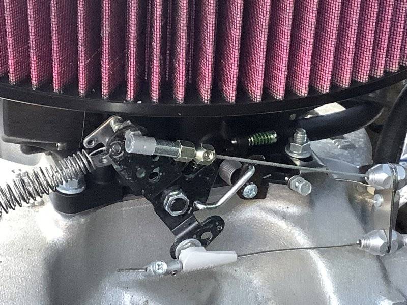

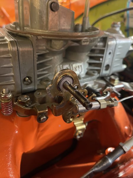

So I’m working on getting the kickdown linkage ratio to match my throttle linkage travel on a custom set up. Fun stuff!
So I’m looking for a specific nylon piece that I can tap a 5/16-18 and have the outer diameter match the inner diameter of my carburetor throttle bracket to use as a bushing.
Digging through all my stash, I find almost the exact piece I need. I have only one. I don’t know where I got it.
So I tap it out and it’s perfect! Just the right size! I slowly file the length to get it to where I to be. But because it’s nylon it’s taking a long time and I’m getting close but it’s taking a really long time and I’m thinking I should just put this on my mini belt sander and just get it done.

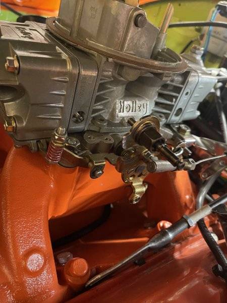

Found it! It flew into the garbage can! I sifted all my trash and there laying in the bottom mixed with metal and wood saw dust was the threaded nylon bushing.
I finished machining it and installed it!
