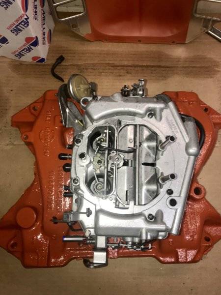

It looks like I can replace the rods from the top by removing the choke link and screw/bracket. Is removing the top of this TQ to get to the primary jets any worse than removing jets in a new Edelbrock? Is there anything that I need to know before taking the top off? At idle my mixture screws are 10 (1/2 turns) out and still have 18 to 19 air fuel ratio in gear. Try’s to cut off at a light from being too lean. When I lift up on the rod bracket while running, the air fuel ratio improved greatly.

So I took the carburetor apart. Was pretty simple much like an Edelbrock. Good news is my jets are 100s. The rods are number 2110. I basically need new rods that the thickest part of the new rod is the same diameter as the smallest part of the 2110 at the bottom of the rod.
Just to put an end to this thread, and thanks for all the advice, I did the ultimate no no. I took those jets and drilled them out and guess what. It purrs like a kitten at 14.0 air fuel ratio and no more idol hesitations or cut off’s. Thanks again for all the help.

The bit was just barely larger than the hole. Could’ve almost turned it by hand. Turned the screws in 4 half turns then fired it up and had about 13 af ratio. Will probably go even more. I was so happy I didn’t even turn them any more lol. Vacuum was a nice steady 15.
You do know that you can purchase new jets and rods, 1966 and 2127 rods are available, and jets up to .105 are available. Also, you mentioned that when you raised the "rod bracket" it ran better. That is the step up valve and you can adjust that valve, just don't forget how many turns in or out you made in case you need to set it back. There is a procedure to make sure its set to factory adjustment.
