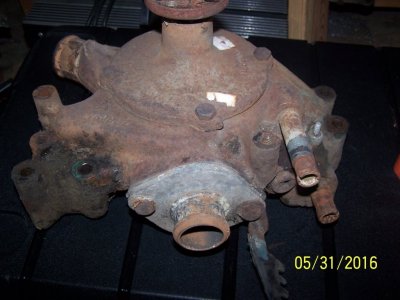

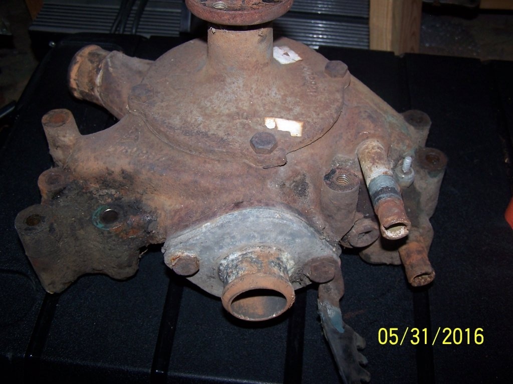

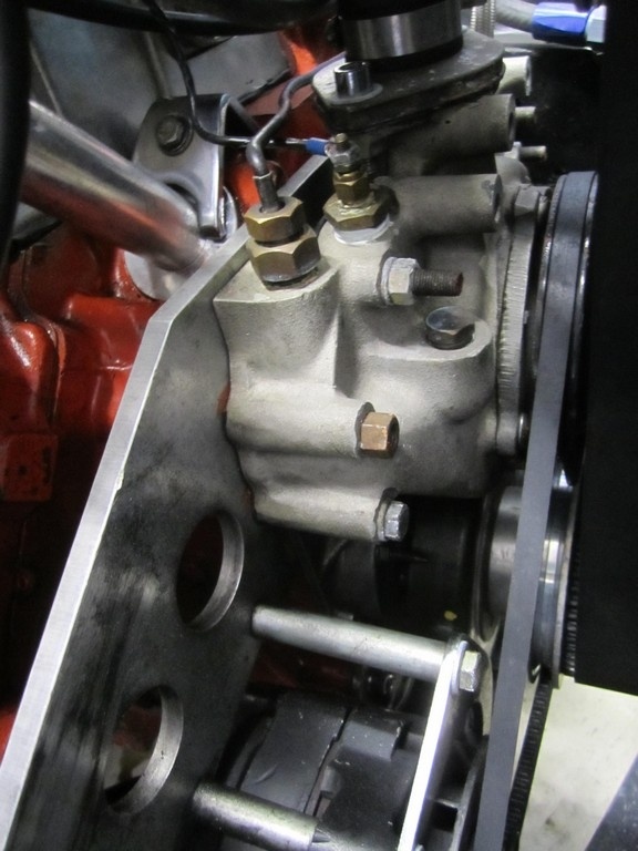

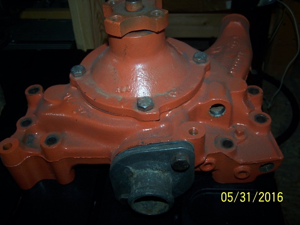

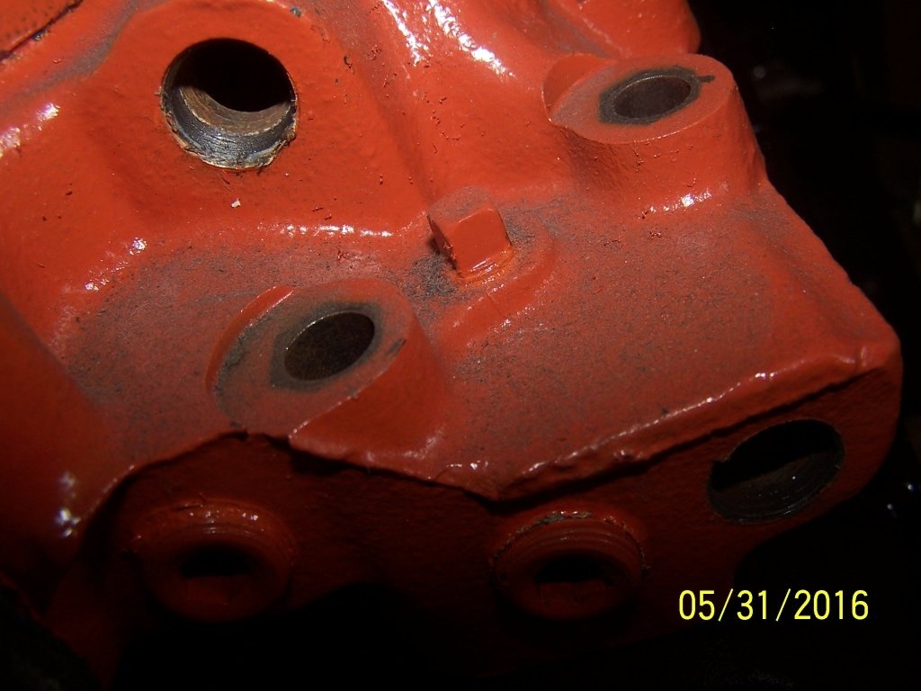

It sounds like you are not using the heater hose connections. They are both threaded and would be an access point. I have never seen a Thermostat housing with anything but a hose connection. Maybe a picture of what you have would be helpful. Here are a couple pics of the only big block water pump housing Chrysler used. Either the left side outlet or right side outlet. Both have threaded holes for the heater hose nipples. They both have extra threaded holes for what you want to do.
