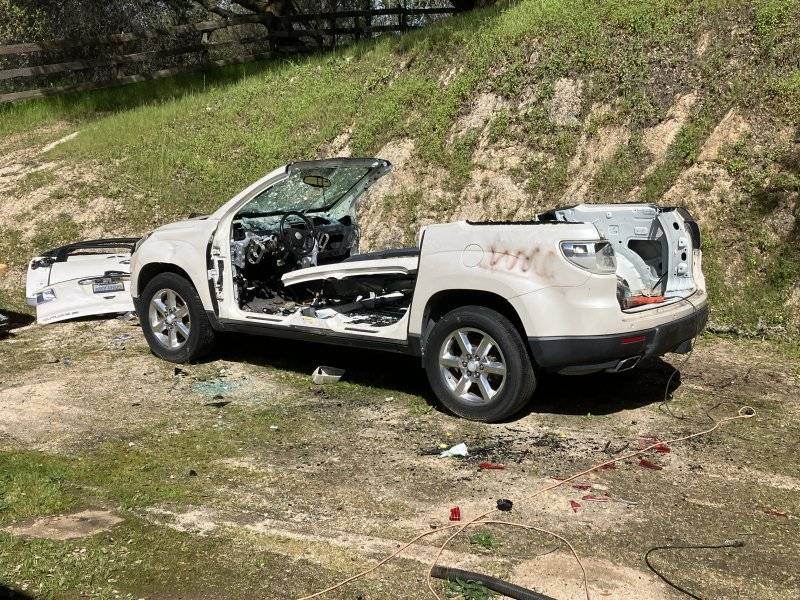

Sawzall time!
They still take about anything around here.

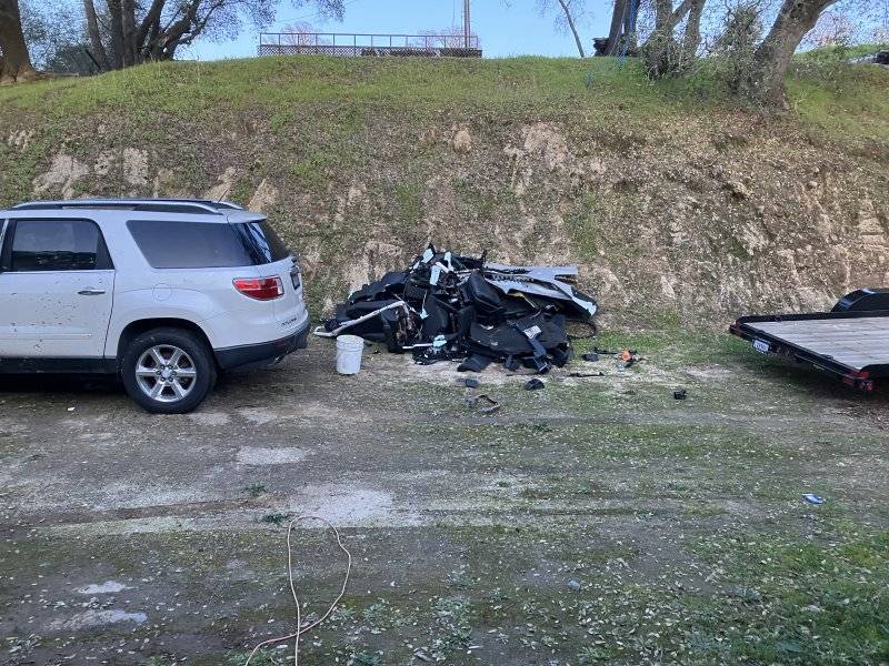

I bought 15 blades and used every one.
A little story on that: the stores keep Sawzall blades locked up now. The clerk has to open the cage. I didn’t see the blades I usually get. These were Milwaukee brand but the teeth per inch was too high. They dulled out too quick and cut slow.
I needed more aggressive blades like the ones made by Diablo.
I worked my way through though.
I pressed on..
This works WAY faster and the leftover pieces don't resemble anything. Cleanup can be a bitch.

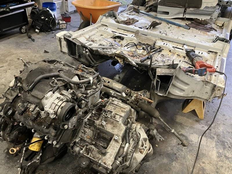

I pushed it indoors to finish.
A lot of the car just unbolted. Nothing was rusty so a lot of it just came apart.
The V6 is aluminum so I’ll tear it down. Aluminum is about ten times the value of steel and iron.
Lots to sort through here… aluminum and wiring.

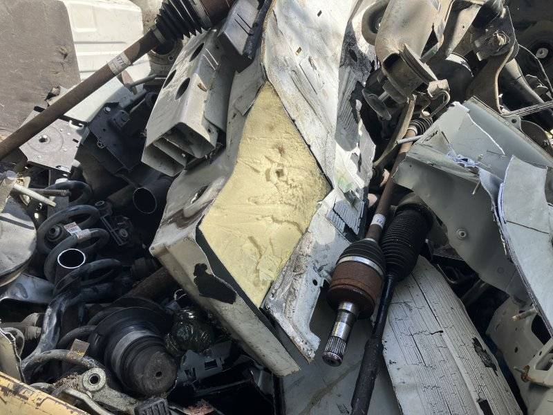

The “ They don’t make them like they used to” applies here. Look at the thickness of the boxed rockers.
There is foam injected in some areas.
Must be for sound?

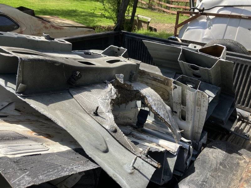

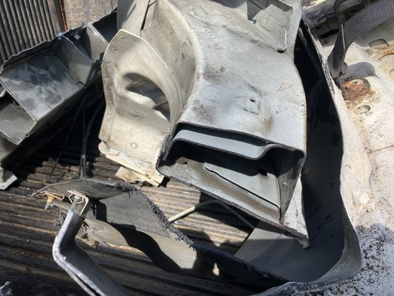

This one will be easy:
I mean, look at how thick the rails are here.

The foam injected into frame rails isn't just for sound, it improves strength and torsional rigidity substantially, sometimes up to 300%. This isn't the light stuff you spray in your walls to seal up cracks, it's a heavy high density foam.
