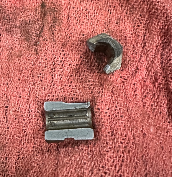

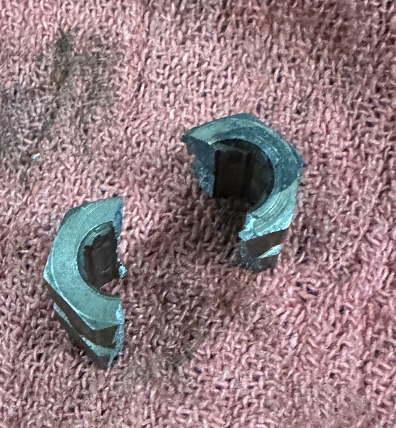

Bought a set. Broke easily with not much pressure. Maybe Rigid’s quality is as good as it used to be? Chineseium?Absolutely. These are made by Rigid and includes the proper drill bit for each extractor. The set even comes with drill pilots for correct centering. They are splined and don't expand the hole like the tapered ones do. The nut slides down to the surface for more strength and less twist. When the end get's damaged from twisting or slipping, you can grind the bad end off and continue using the tool. These were a very popular sale on my tool truck. View attachment 1944785View attachment 1944793
