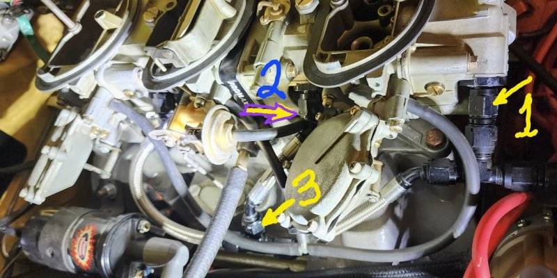

Initially I got the Promax braided 6bbl fuel line kit because it looks fantastic and may have performance advantages, but I am so happy with how much EASIER it makes all aspects of servicing the carbs!
ANYONE who runs the Holley 6bbl carb system should know how much EASIER it is, by leaps and bounds, to use a braided flexible fuel line system like the Promax system I have, especially if you are going to be tuning, troubleshooting or racing your car!!
I only had to back off 3 fuel line connections to remove the front outboard carb and then the fuel bowl and metering block were ready to come off the center carb!!!
I numbered the 3 fittings I had to loosen:

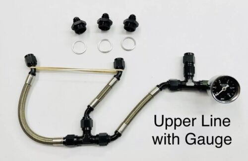

looks like you bought the upper and lower kit,any pics on how it hooks to the Fuel separator ?
Yep...like those..I got the lower pump to supplied reusable washable 40 micron filter main feed fuel line too.
I couldn't figure it out so I plugged the return line.
I do have a brand new vapor separator to incorporate into the fuel lines if anyone can show me/us how it's done.
Thanks. That pic of the installed items, fuel pump, sep, lines, etc is clear and THE layout.
