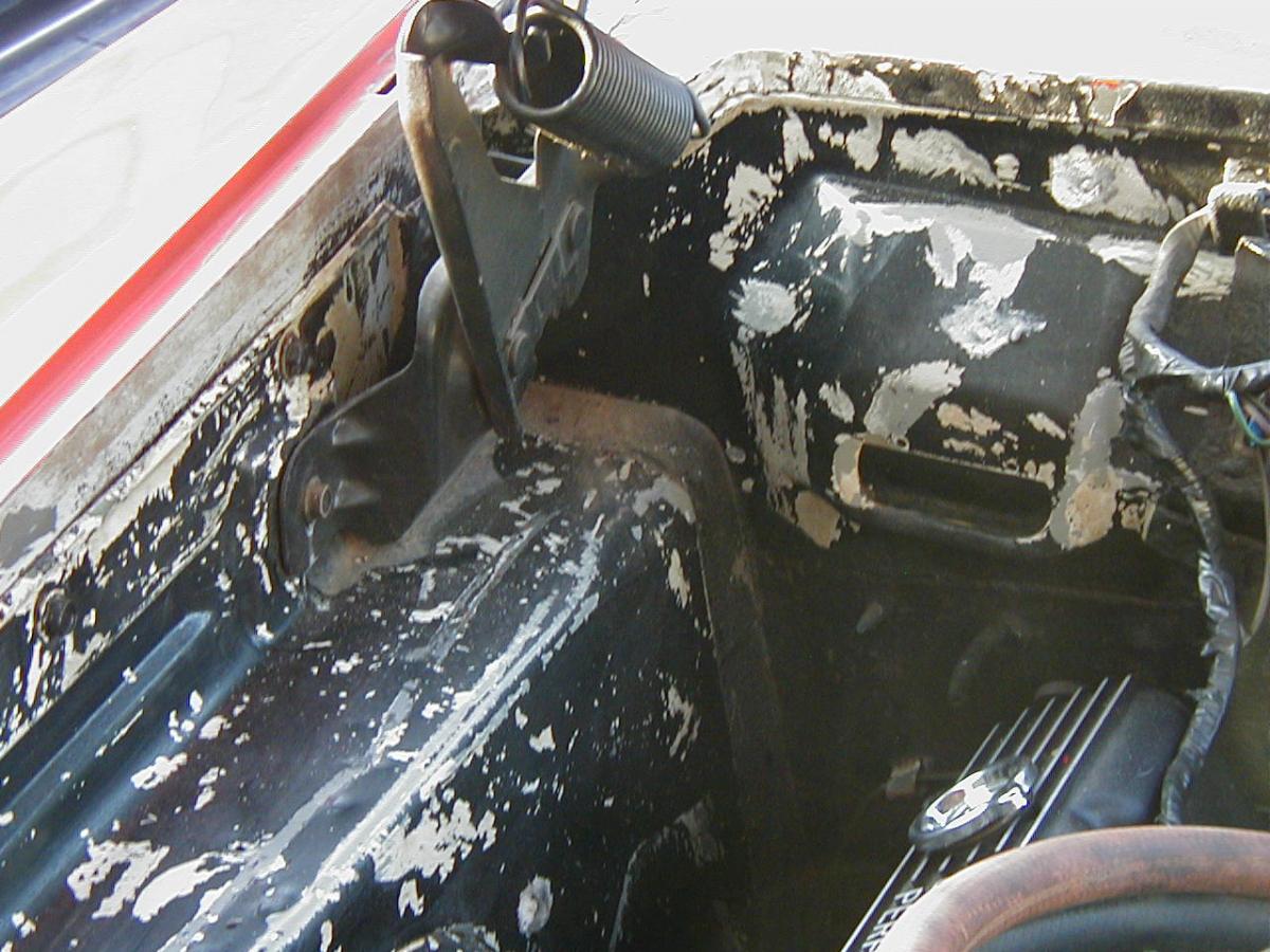

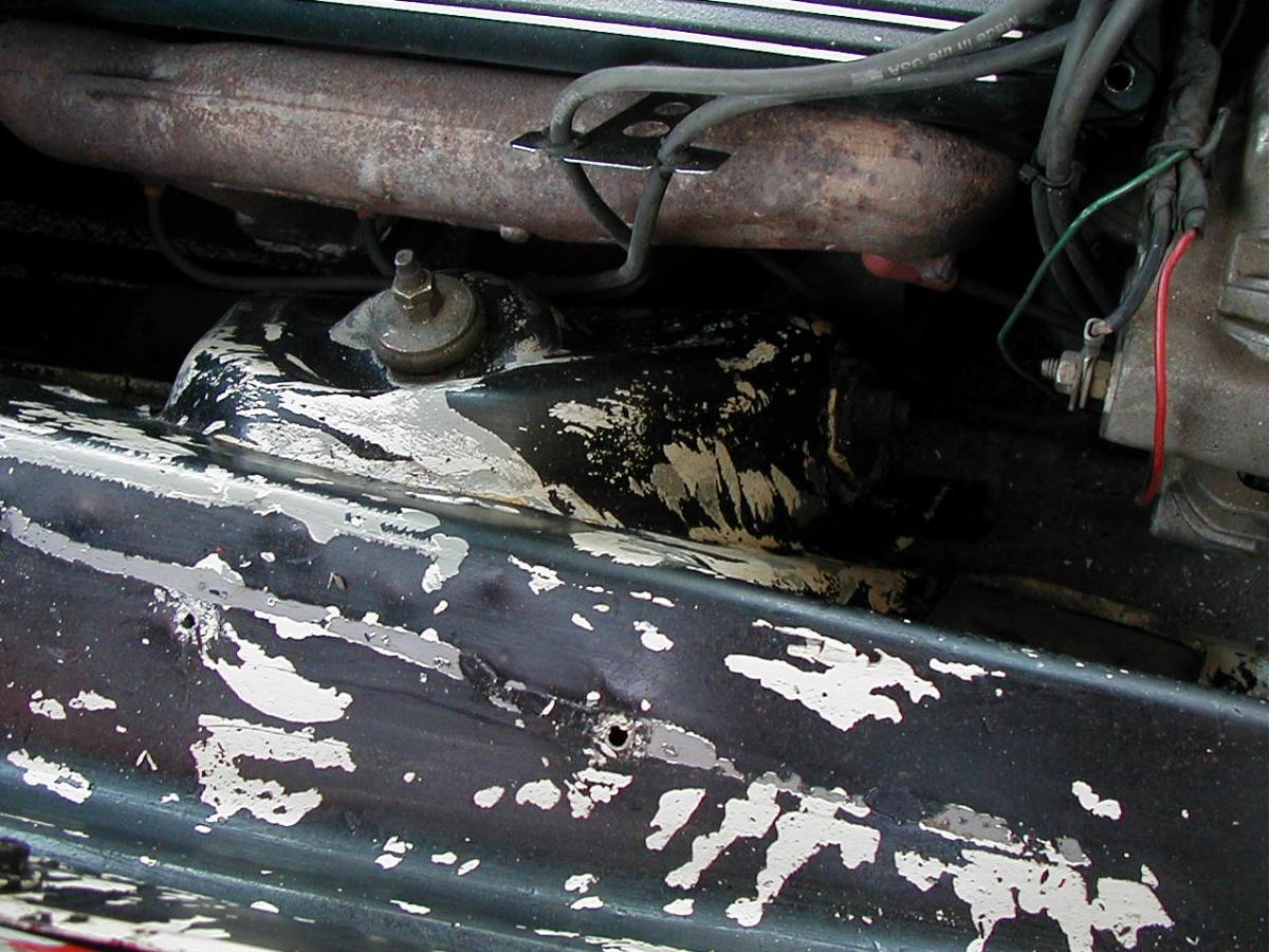

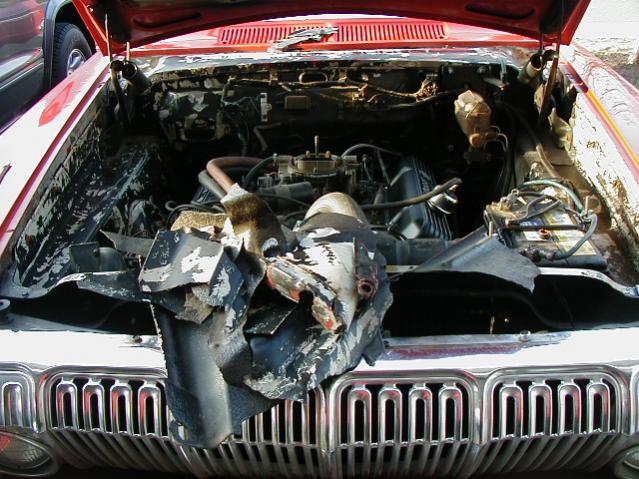

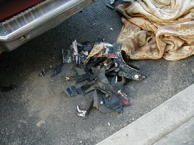

Update
Went out for a short drive today to burn off the gas in my old tank. New tank, strap, super stock springs, shackels and shocks going in this week. When I got home I opened the hood, picked a spot and just started pulling, after about an hour this is what I had. It wasn't all that hard to remove, finger nails and a pair of channel locks. The sad new is I didn't find the fender tag and I broke a nail! I will have to remove all the electronic from the firewall to get the rest of it off. It appears they plugged all unused holes before they sprayed it with black primer, the white you see is where the bed liner pulled the primer off. Afterwards everything was bolted on except for the original washer nozzels and hose which was sprayed over. The metal is spotless, no rust at all can be found.

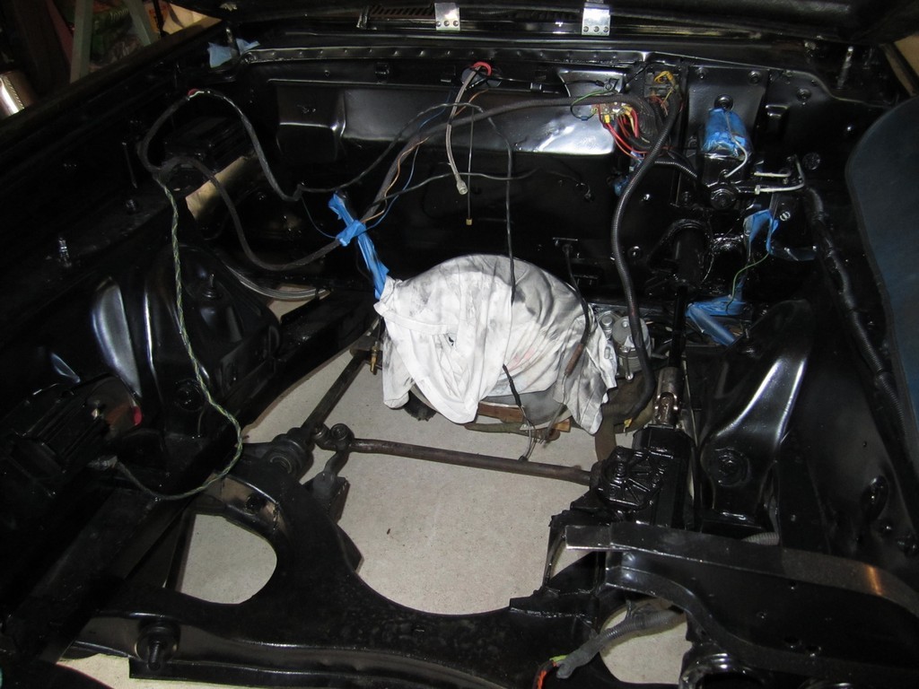

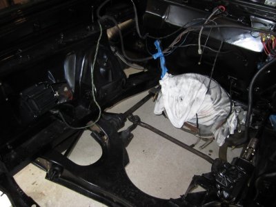

Mine's black too,sprayed it recently.Just waiting to fill that big hole:munky2:
