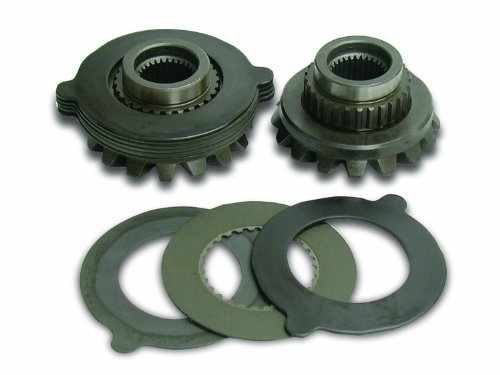

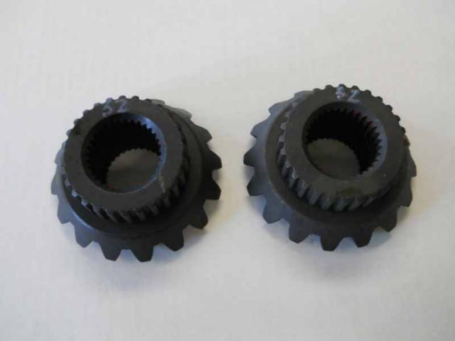

Actually no, its for all intents and purposes new. It came out of a late model ram with 2000 miles on it. Heres the deal. Its being modified to fit in my charger. It didnt have axles in it when i got it and they were full floating anyway, and 30 spline. I want to put 35 spline in it and apparently the side gears are harder to get for some reason. Before i took it apart i ordered a set and they are not correct. The only way i see the right ones offered is in a complete kit with spider gears and clutches. This costs about the same as the yukon locker. I figured if the locker is a better way to go than the clutch style trac lok i might as well do it
This is what i need
This is what i got cause I didnt check it first

I know you did. From what i have been reading the new yukon is getting good reviews. Supposed to be a better stonger piece. But if that wont go in my carrier i need to get an open carrier. They look to be around 150 for a used one. That plus the locker. New bearings. At that point i could get a detroit locker carrier and slam it in
