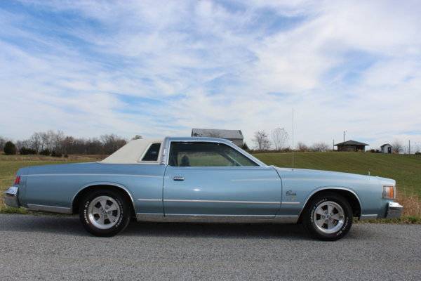

Do you have a profile shot of the car?
Yes, this is when I used to have 15x7s on it with 235/60/15s all the way around from a few years ago. Now, the car has the turbine wheel covers and hubcaps on it currently.

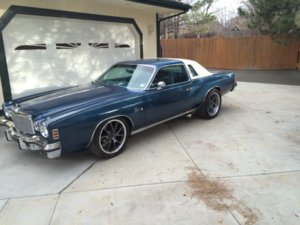

Rears are 20x12, front were 20/10. both with spacers. Sold the set, installed 15/7 with 255/60 on rear and 245/60 on front. The wider rims were just too too wide form high speed driving

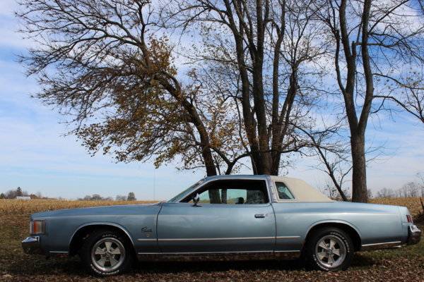

I have been running 255/60R-15 tires on all four corners of my '79 Cordoba 300 package car (SS22L9R) since the early 1980s with no issues of any sort. All four wheels are Enkei 15x8 (or 15x10).
The car is all buttoned up in storage right now. I can find the wheel size one weekend when it isn't raining.
Below is a picture from 2015 when I had it transported to my new home. The Enkei center caps were removed so that they didn't mysteriously disappear during the trip. The car is very dirty in this picture.
I gotta be honest with ya, your car looks great with those turbine wheels.

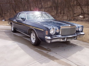

I bought my 77' with enkie 15x8's with 235/70-15,and thought the width and size degraded the ride and driveability. I re-installed the original 15x6.5 wheels with 225/70-15, which most closely matched the GR70-15's the car was sold new with. I then re-installed the wires the car came with. The stock look is Not for everyone, but it looks just like the commercials in 1977. The car is as smooth at 100 as it is at 70 mph. The car has a 400 four barrel, police suspension, and 9 1/4 suregrip 3:23 rear.
Lots of fun to drive! (For a while I had cragars, but they found their way to another car)
