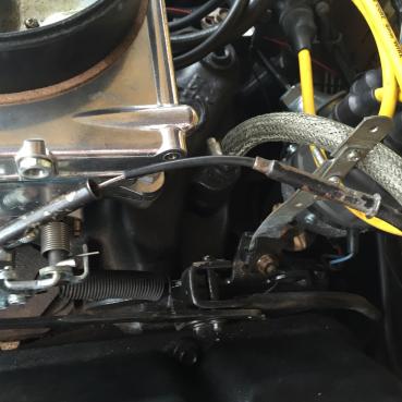

I have a 1974 charger with a 360. Street Demon 625 cfm Carb with Edelbrock spacer. Ever since I hooked my Demon carburetor, the throttle cable needs a bracket so it can be properly placed. I have tried a makeshift bracket from parts I had laying around and it finally went faulty today and need to get a real bracket. I believe my intake is from around 1989 motor because that is what my gooseneck fit for my thermostat. I would like to know any suggestions or ideas about a throttle bracket and what yall use? Any help would be appreciated.

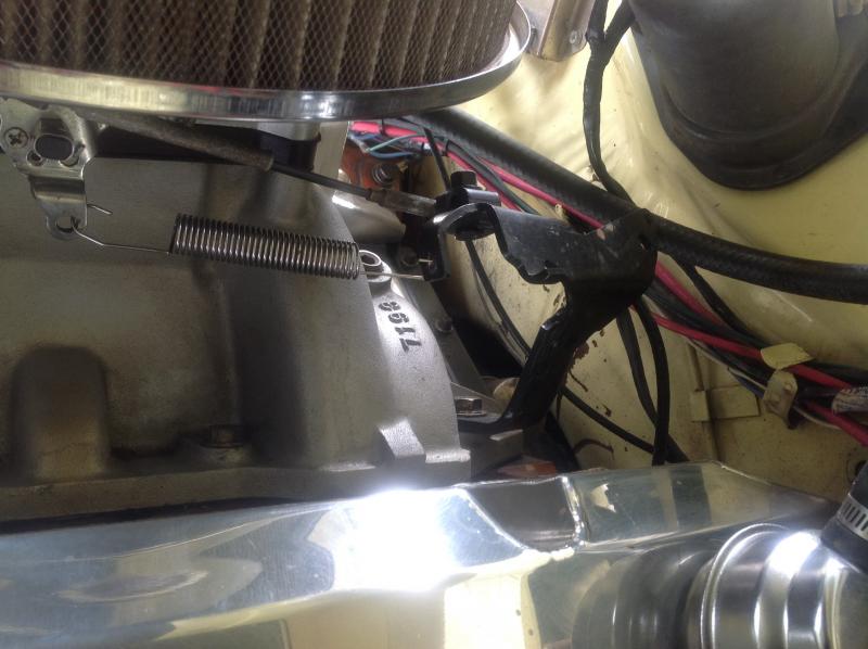

Don't know if this will help.
Is that a bracket you can buy or one you built yourself? I need one like that. Thanks Kevin
What is the part number?
If I'm not mistaken doesn't the kick down linkage share the throttle bracket also. Do you have your kick down hooked up still? I may have a spare org bracket I'll have to look threw my bracket bins . If I do you can have it just pay for the shipping witch will be like 5 bucks p.m. me and remind me to look tomorrow I have a bad memory. I'll take a pic of my 340 for you and 318 for reference pics
I don't know if this will help but i need the throttle bracket to be tall so it won't interfere with the carburetor linkage and moving parts.

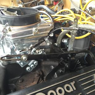

Any pictures on a solution for the throttle cable and transmission kick down? I'm stuck in the same issue...318 with Demon 625 carb linkage problems.

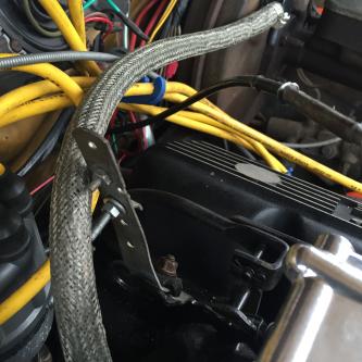

I took a grinder and sliced the attachment legs off my bracket, then welded two spacers between the bracket and the legs to get it to the right height I needed. I used some 1/8" bar stock from Home Depot for the spacers and a $100 wire welder from Harbor Freight.
