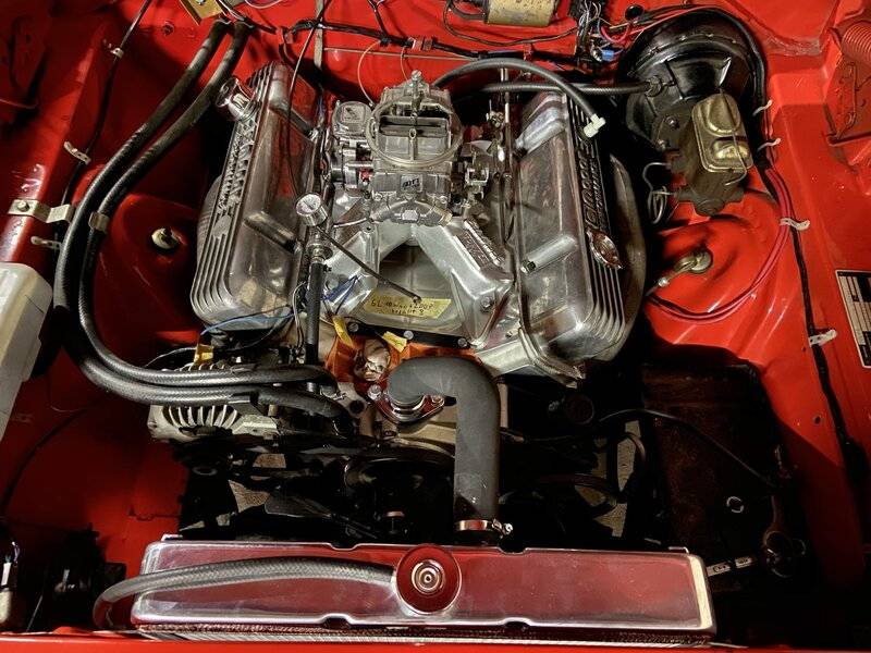

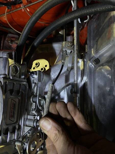

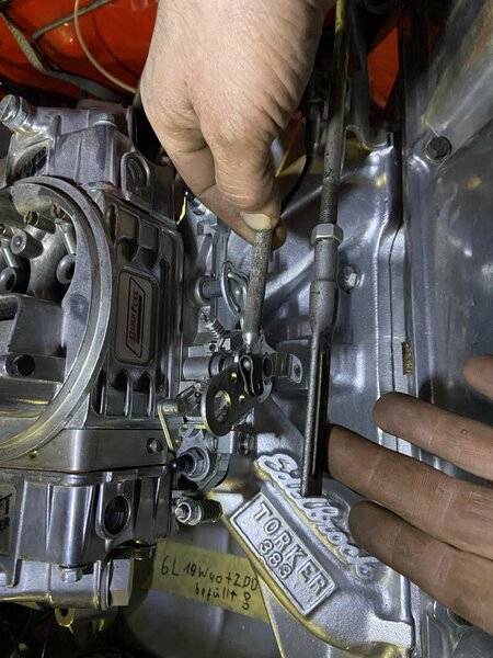

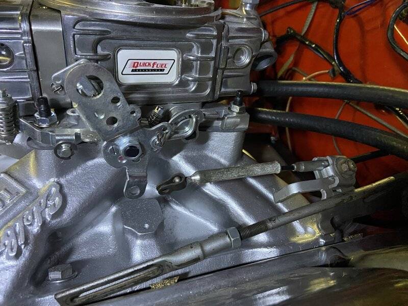

I need help for my throttle braket and kickdown linkage on the new 496 stroker. It has an Edelbrock 383 Torker Intake with Quickfuel Slayer carb. The stock throttle cable and kickdown linkage doesn‘t fit anymore.
What Bracket Kit do I need??
Is this one the right for my needs?
http://www.hughesengines.com/Index/products.php?browse=search&search=Throttle+bracket+&partid=25454
And will I need this one, too??
http://www.hughesengines.com/Index/products.php?browse=search&search=Kickdown+&partid=25465
See some pics here:
View attachment 1029689 View attachment 1029690 View attachment 1029691
1798AD6A-4D9F-414E-B7CD-C6D431BE8D5A.jpeg 30962A43-72E3-4993-BA92-559EFBCE136D.jpeg 51D5F757-4C40-4768-9736-C536F58CB960.jpeg 660843DB-AEF6-4C00-8629-D39DD0165455.jpeg

Depends on what kick down linkage you have now. If you have a factory 3 piece linkage then use the AR036 throttle bracket. If you have a one piece kickdown rod then you might want to go aftermarket. You should read the instructions before you order the parts so you can verify that it will work for you.
http://arengineering.com/products/383-rpm-performer-with-kickdown/
