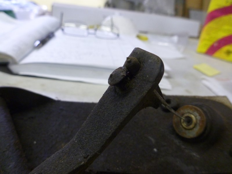

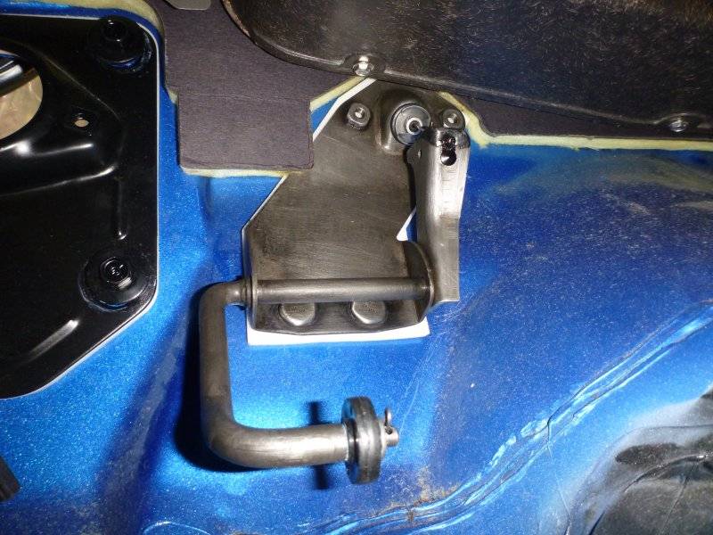

GKENT, What holds the cable into the pedal assembly? My cable freely moves through the pedal bracket and the hole in the firewall. Ther emust be a rubber grommet or seal or something that blocks the hole in the firewall to keep fumes out and hold the cable in place. Is there a c clip that holds the cable in the pedal assembly? thanks again for the response.
DadsBee, thanks for sharing your before and after picture of the throttle pedal assembly, looks like mine. Except for the rubber seal around the gas cable. Do you have a closer picture or a stand alone picture of the grommet or bushing or what ever it is? Mine had nothing on it when I got the car, except for the loose cable.
Best I've got. Zoom in on it and you'll see it's just a rubber plug.
Maybe someone else will grab you a close up shot... I'm off to bed and camp bright and early.

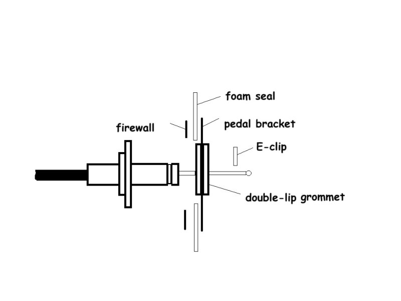

My '69 Charger with 383 came home from the restoration shop missing a few parts and I'm trying to complete the missing installations. Specifically, the throttle cable. From reading this thread, it seems that there is a lot of confusion about how the cable interfaces with the firewall and the parts required. I'm in the same boat. The photos previously posted answered most of my questions, but I'm still not clear on the detailed assembly of the parts. The attached sketch is my best guess for how they fit together. Is this correct, or how do I have it wrong? Seems like a rubber washer is missing. If so, where does it go?
Thanks!
Thanks!
In the pic, the double lip grommet is the rubber washer you seek.
Correct. The grommet goes on the pedal bracket before its bolted to the car. In fact, assemble the whole damn thing FIRST, then slip the cable through the firewall from the interior and bolt everything down. It can be a bitch trying to install the cable from the engine compartment - AMHIK !!!
