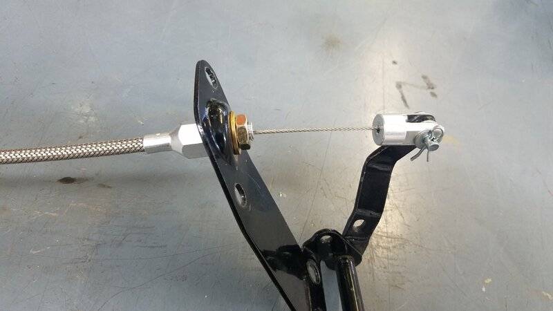

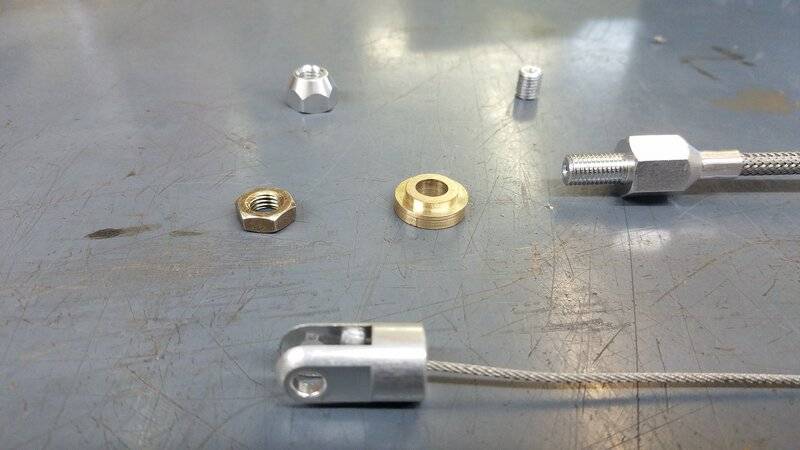

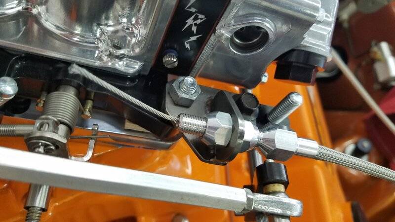

I just bought one of these. Very nice. Made a simple bracket at the carb. Even in the position its used in this application I cut aprox 8" off. Instead of the rubber spacer at the gas pedal I made one from brass. Cut the threaded end down for full travel. Slant 6 is the longest or factory cable.

That looks identical to the Lokar cable so that should work for me as well, ill get the 24" variant and shorten it. Awesome, thanks a bunch!

I have tried to research this a bit myself and from what i understand the lokar cables fit the stock pedal if you remove the clevis pin, does anyone know if this is true?
They fit

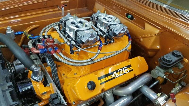

I had a similar siuation wih my 65 Bel. I am using an M-1 singal plane wh a Holley. I ended up with a 24 inch cable, and an extended height adjustable cable mounting bracket. This setup also allows me to use up to a 1 inch carb spacer, if I choose to. It all came from Mancini.

Thats what I use the Lokar cable. Good thing is the bracket that holds it bolts to the rear carb stud so it will be at the right height. I have had the Lokar cable like that on my 63 since 2006. Ron
