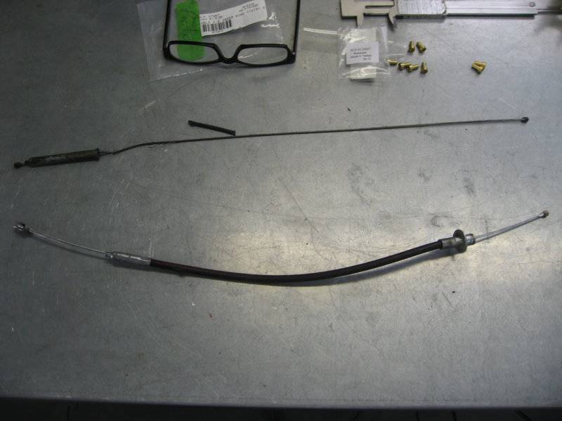

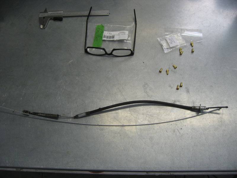

When I needed a throttle cable for my '66 318, I couldn't find a new one anywhere. I had one place out on the West coast who would build me a new one - if I sent them my old one! I checked out our local motorcycle shop and ordered a new inner and end pieces from a dirt bike supplier and made my own. That was in 2014 & it's still going strong. Why not give it a try, nothing
to lose.
