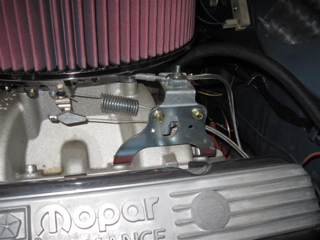

the lokar will work. I have one on my 67 coronet and a mancini tall manifold bracket. see photos!
