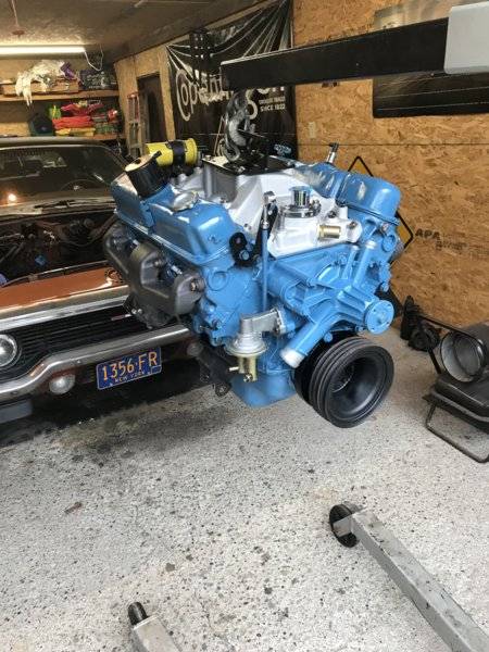

Finishing up my new 340 build and stuck on throttle/kickdown linkage. I'm used to factory set ups. So it's on a 71 SSP with a 904 and new 72 340. Sitting on the 340 is a RPM Performer Manifold and AVS2 carb. What's everyone using for aftermarket set ups like this? I currently have my old 318 linkage kind of on it enough to run but it's too low and brings throttle cable back too far.

I usually cut/weld my own, but Hughes Engines sells Andy F, ARE throttle brackets.
Check this link:
http://www.hughesengines.com/Index/...y&level0=TC0gQVIgRW5naW5lZXJpbmcgUHJvZHVjdHM=
i use the bouchilon. Looks like hell but is reliable and easy to adjust.
