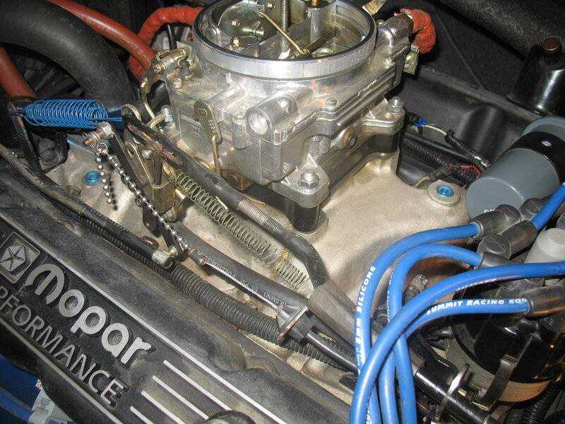

Have 2 springs on my xram but doesn't help if you screw up. Was at a NeHOA meet in Ny came out in the morning to start my car. Hit the gas and ready to hit the key then realized gas stuck to the floor. Bellcrank went over center. Tried to to see if it would do it again out of curiosity nope. Been driving like that for awhile. Took both arms off and lengthened them 4 turns. Yes they had lock nuts.
Hi Fran,....Big thx for your Bellcrank "Over Center" stuck throttle safety reminder !! Had a cross-ram Race Hemi Bellcrank (A990 motor) stuck wide open low psi wrinkle wall cheaters on a narrow curvd street concrete underpass experience back in '72 ! ... That'll Deff tighten your pucker ! ...Keep those return spring anchor points way Above pivot pin ! Thx, ...tom.
I have never had a problem with a broken spring but I put a dual spring on my 73 Dodge B100 with Edelbrock carb & intake, looks kida cool with additional benefits of safety.
