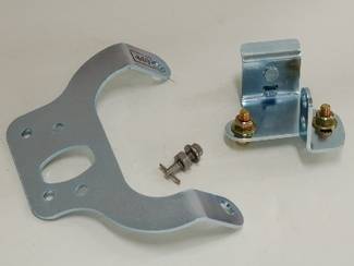

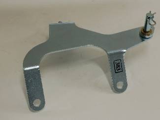

they make them for a B-383 or RB-440 auto or manual
the taller spring bracket seemed to pull back better than
the org. spring bracket wanted to pull down, more than back
if that makes any sense
