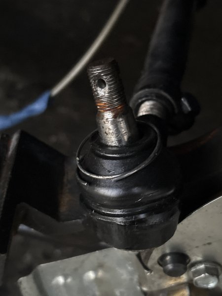

The tie rod boot got damaged using a pickle fork. I have some replacement boots, but I can’t seem to get the ring that holds the tie rod boot on. I fought with it for a bit, but am I better off just getting a new tie rod end?
Looks like that is cheap Chinese junk. So yes you would be better off with a quality tie rod end.
It’s a new end, but I have no idea of the brand. Moog is $34. Maybe I will change it then.

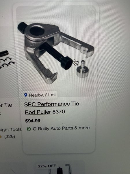

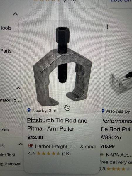

Not going to help you now, but for the future, buy a tie rod puller. Maybe even a Pittman arm puller too. Pictures are for reference only. Buy good quality units.
I know, I could have borrowed it from Autozone, but I usually can do it without damaging the boot. It has a small tear on the top. So I figured I would just replace it.
They just are. Get one side started and stretch it out and around.
