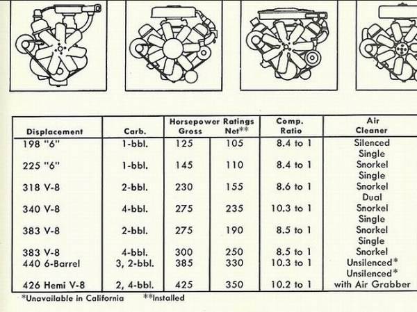

That's the ratings for 1971, virtually unchanged from 1970. NET ratings are fairly realistic, that's with the accessory drive, full exhaust, air cleaner, and radiator fan. With a .509" lift / 242* duration @ .050 camshaft, headers, & full-exhaust; I would assume that you will have another 50-60 HP at a minimum. There is something wrong, could be something very simple, a lot of speculation at the moment though. Wideband 02 sensor would tell us the full story pretty quickly.
