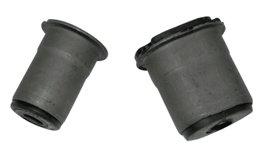

One more time....
GM LCA bushings = lots of rubber = lots of deflection...

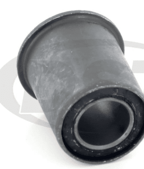

Mopar LCA bushings = very little rubber = very little deflection...

With a GM something needs to be done to keep the alignment stable...
With a Mopar things are already stable..
