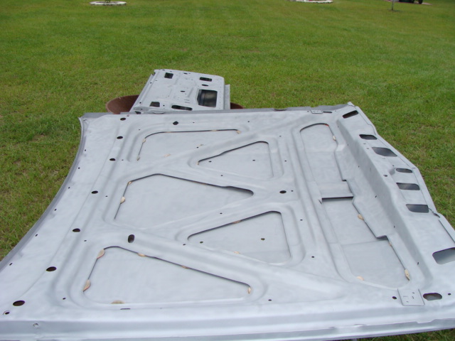

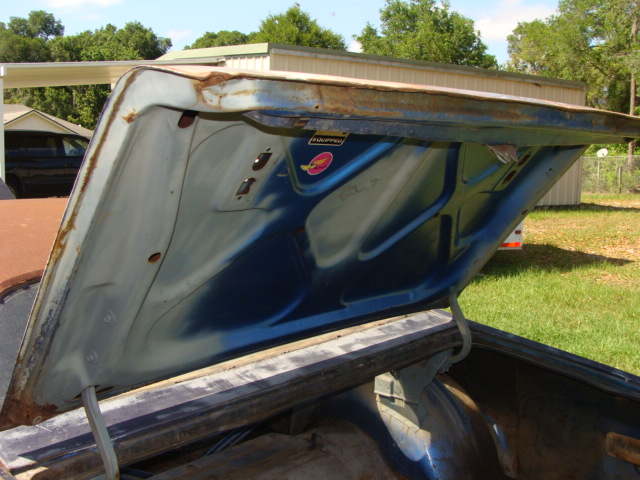

You may have a hard time getting the caulk type material in between the inner and outer layers of the trunk lid. These areas are not easily accessible without being able to get to the inner and outer layers of the trunk. The stuff mentioned above may be your best bet. The trunk lid isn't made like the hood is. I attached a picture of my 71 RR trunk lid to show you what I'm talking about.

In this picture you can see how the caulking is in between the inner and outer layers of metal. This is an example of a Plymouth duster hood. The 71 -74 B Body hoods are very similar.
