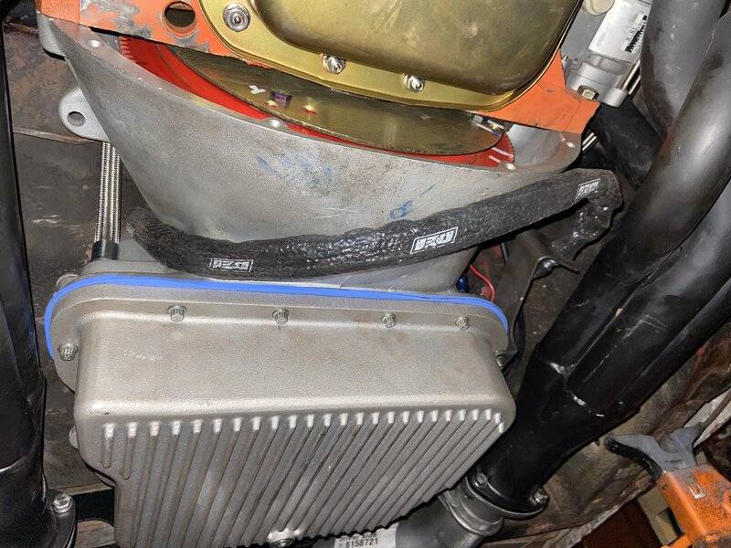

Got a 68 Charger, 383 with Hooker Super Comp headers and Hurst Pistol Grip. Holy cow is the cable tight to get to the trans. Previous A-Body project with same products went in easier! Not so much these B-Bodies.. ha
Already melted one cable. Any tips to avoid further? Gonna try heat insulations+tape on the end. Gotta literally run it through the headers after looping around from torsion bar.

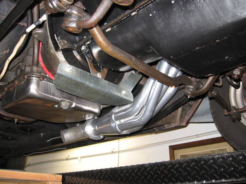

In the photo you can see the red cable. I also made some heat shields out of scrap tin.I was using a B&M pro ratchet shifter.You can use some House wiring
such as 12-2 to get the length of the cable from shifter to shift arm.The stiffness of the house wire helps in molding the path. Worked for me !

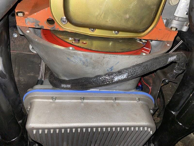

I put a heat sleeve on mine and routed it between the starter and the block to keep it off the headers. It has survived for many years there.

Shout out to y’all. Looping down the passenger side and around was the ticket. Not only easier on the cable, but only one real forced area near a header. Brilliant stuff guys! Thanks!

it looks like either a different cable mounting
bracket or tweaking your existing one to get the cable in a more straight line will help even more. Either way you look good to go now.
