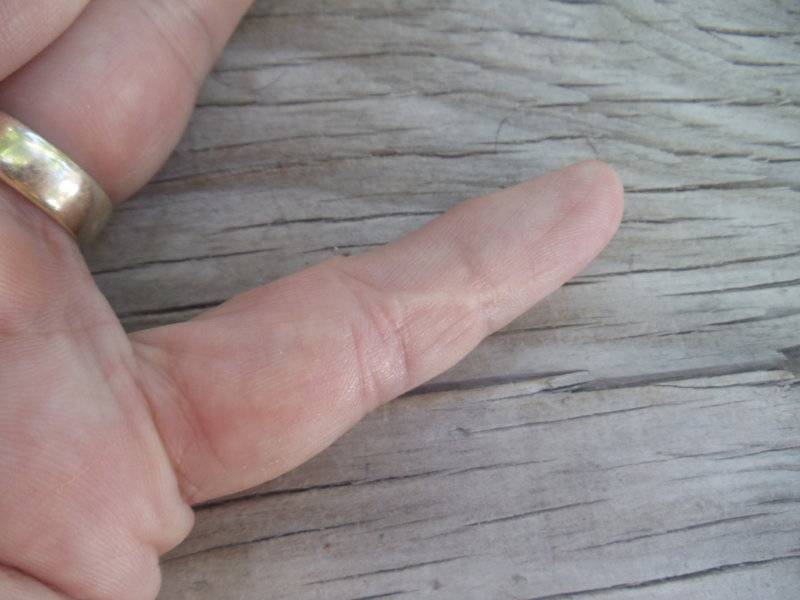

Just an anecdote: pulling the four-speed (working alone) from a '65 Abody, i did not need to plug the driveshaft hole (ball and trunnion driveshaft). However, when the tranny dropped out, the rear trans flange (where it connects to the ball and trunnion) game down hard on the concrete--correction--on top of my little finger, almost cutting it off. I know I successfully removed the 4-speed onto my chest, but something went amiss thereafter.
I should have gotten stitches, but at 2:00 or 3:00 AM on a cattle ranch, I applied pressure for a long time (and was cussing for a longer time). Eventually I got accustomed to seeing the jagged scar.
