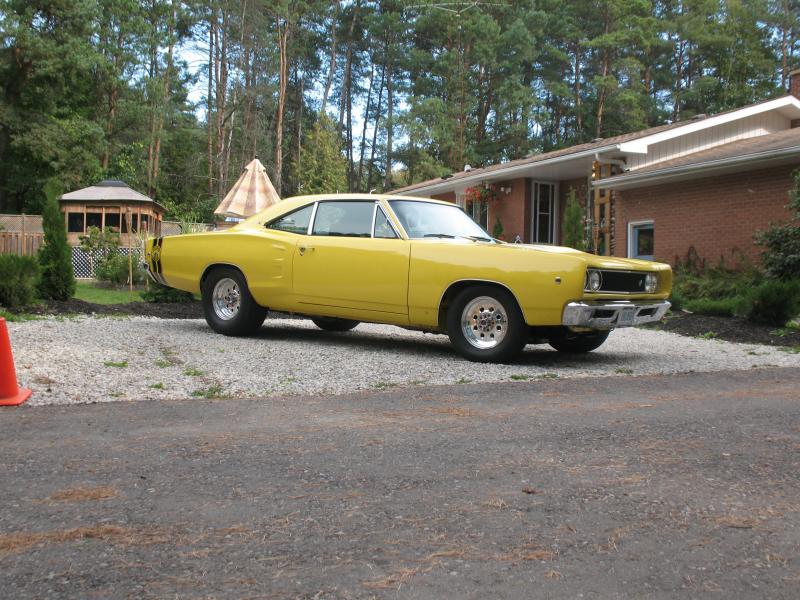

I'm upgrading to 15'' rims on the front for the disc brake conversion I'm installing and wanted to get some tire size options to fill the wheel well without causing problems. The rims are 15x7 3.5 backspace weld draglites
I was thinking 235/60R15...225/70R15... what r you guys running? Any help would be great. Thanks

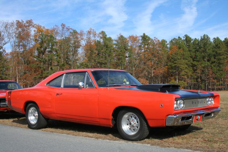

Thanks for your input, The car in the picture is the one I'm refering to it has the 14'' on the front in the picture with 215/75R14 mounted.
I'm looking to fill the wheel well without hitting the frame rail on a tight turn. Thanks for the measurements I'm going to go out and measure the wheel wells.

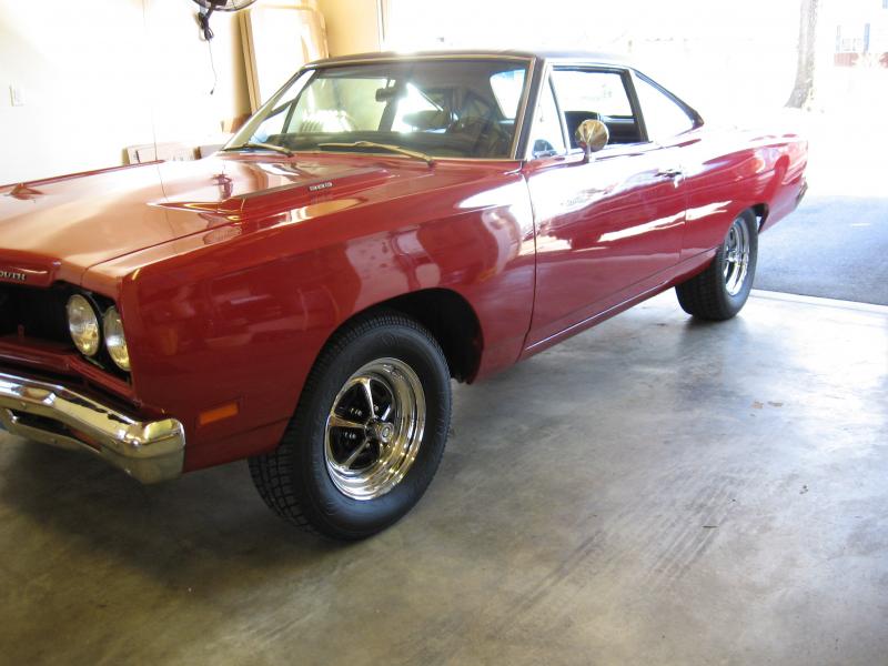

you can get allot more tire & rim in a 68 B-Body, there are a ton of tire size threads here & in the racing forum too... I currently have Polished Halibrand Slots both front & rear on my 68 RR, 15x7's w/245/60/15 front, 15x8's w/295/50/15 rears w/BFG Radial TA's, no fit or rubbing issues what so ever, you can go much bigger even, the 68-69-70's have huge wheel wells, ride height & proper back spacing will dictate allot of what you can fit, the wheel well gets thinner/narrower as it gets toward the top... It ultimately depends on what look your after or how big or stock appearing your going for... there is a very good Percy Tire Fitment Tool sold by Summit Racing &/or Jegs for like $70, you can use it for many different size bolt patterns, rim sizes, back spacing, diameter, width &/or tire diameter widths/sizes, to get an absolutely perfect fit, with out guessing... IMHFO well worth the small investment, especially to get the proper looking & perfect fitting rim & tire combo, that will fill the wheel wells & look the best...

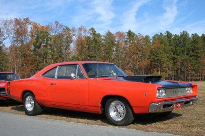

I had 225's in the Front and 245's in the Back; but I always thought they looked to be too small. I'd go at the very least 235 in the front and see if you can fit in a 255 in the back to give your Coronet a nice meaty tire look to it.

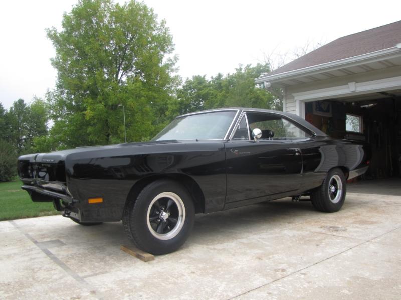

I just put these on yesterday,15x8 rear 4.5bs 275/60/15.15x6 in front 4bs 225/70/15new shoes 005.jpg.new grill should be here wed,replaced my front harness and all headlight hardware.

Right now the back are 275 60 15 with 15x8 and the front are 205 70 R14 with 14x7 rims in this picture.
The 15x7 are will replace the front so the new brakes will fit.

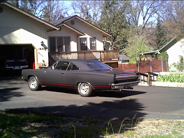

here's my girl, in April 2011, not the best tire photos thou, stance is lower in front, higher in the rear now too... I don't have a camera that I can use/compatible with my new computer yet either...
