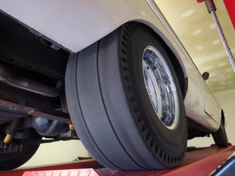

I took my 1964 Dodge Polara to Goodyear to have the wheels/tires dynamically balance due to a vibration. The existing tires are a little unusual as they appear to be some type of re-cap, bias ply, cheater slick. Anyway the guys at the shop suggested that I use them for shows, but they really should be replaced if I was going to drive it much. The existing tires are 29" diameter with a 11.50" section width on 10" Cragar SS rims. The car is a 383, 4 barrel car, automatic, with a 2500 rpm stall and 4.10 gears.

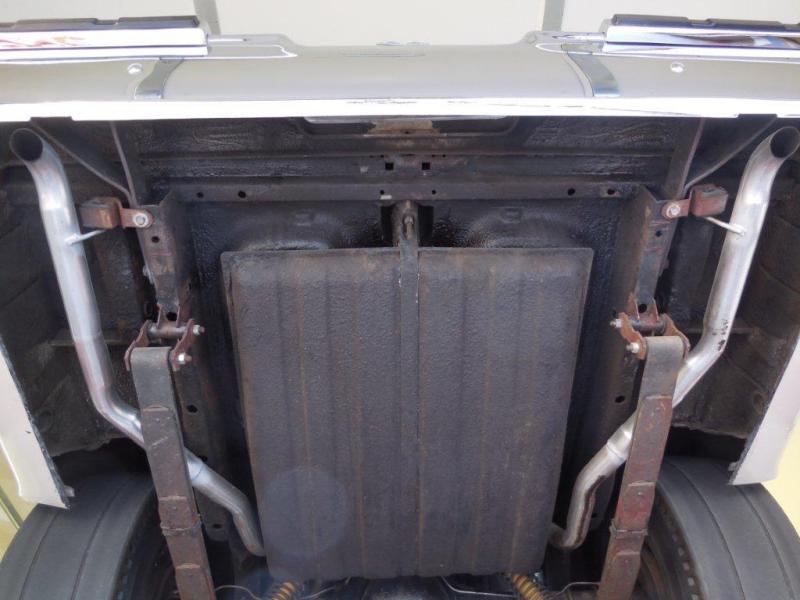

If at all possible I would like to go a little taller to try and combat the gear ratio. The tire I was looking at is the Mickey Thompson Sportsman S/R in size 30x12.00R-15 LT (I don't know why they put the LT on the tire). I pulled one side off and hung string lines from the inner fender wells (which are the limit on clearance due to having a later model B body rear end) and the face of the brake drum. The distance between the inner and outer fender wells is 15". The distance between the brake drum face and the inner fender well is 7" and the distance from the brake drum face and the outer fender well is 8". I have some questions:

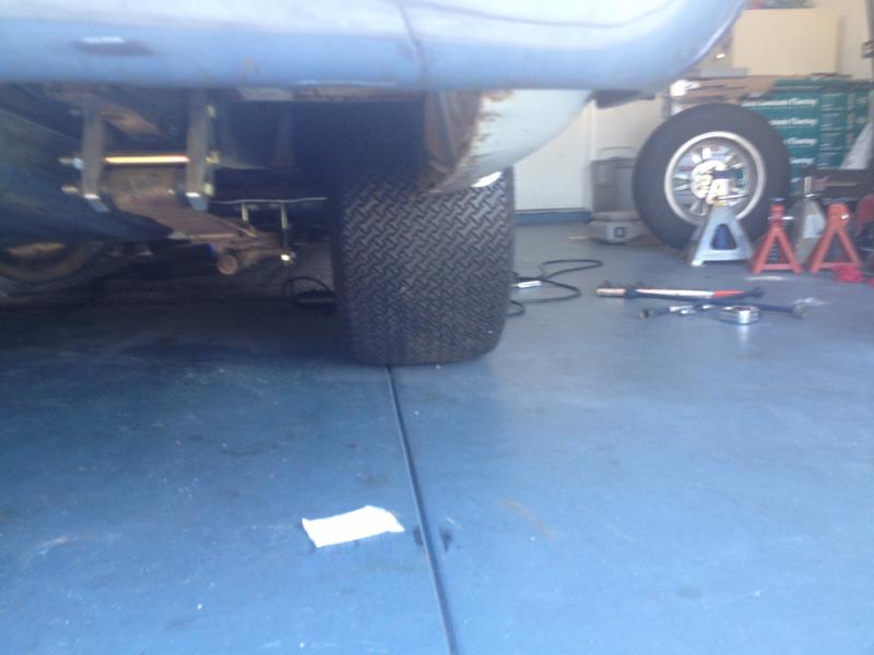

I have a 10.5 with a 6.7 Backspacing but mine is mini tubbed. Its a 17 inch wheel with a 325 drag radial on it.
M&H I have plenty of room left over too. I could have fit the 390

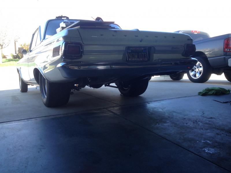

Mickey Thompson P295/65R15 section width 11.9 diameter 30 i have these on 8in 4 1/2 backspace steel wheels

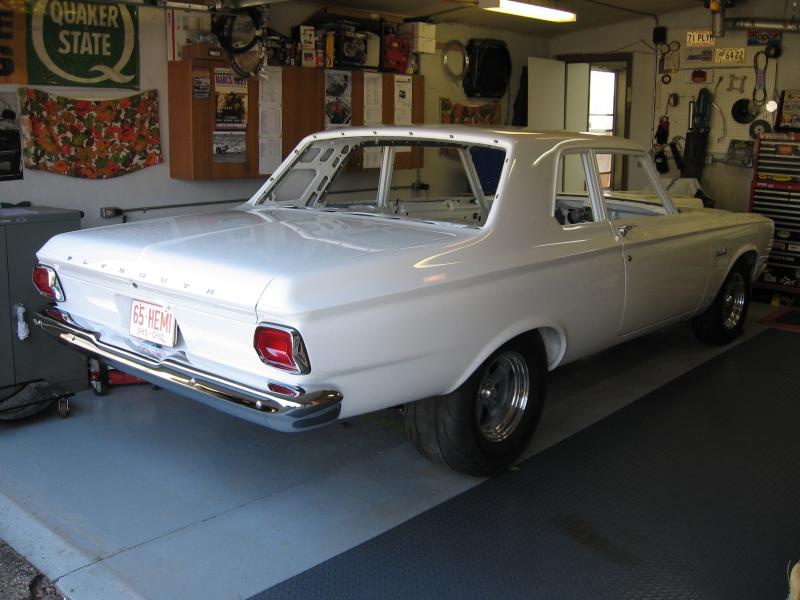

So I am all new to the Mopar scene. I have a 64 Plymouth Savoy race hemi clone and am looking to get some tires and wheels for the rear. I think my rims are 7 or 7.5 so I need to get a couple of wheels and buy some drag radials. This car needs some rear grip!. Any help is appreciated!
