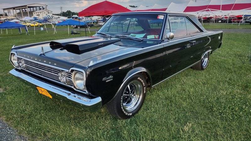

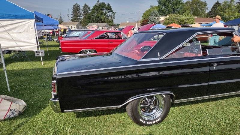

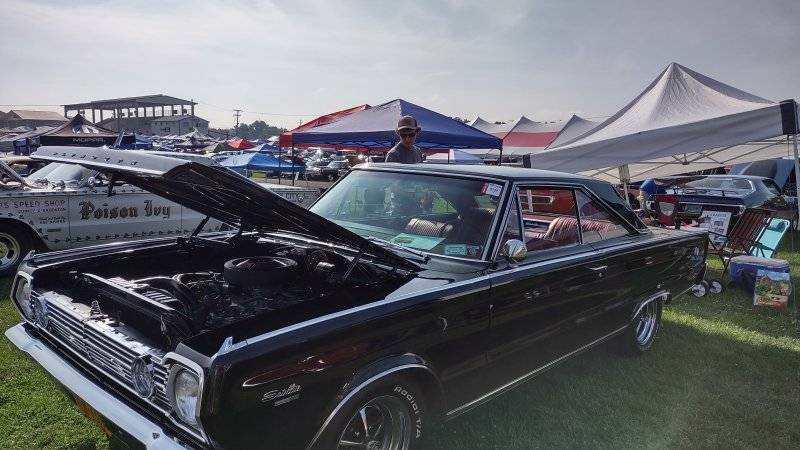

Do you already have the 15x8 rims? 7's seem to be more common with a 225/70 tire. That might help the fitment under the car as well?
Mine has 15x8 on the rear and 15x7 on the front.
