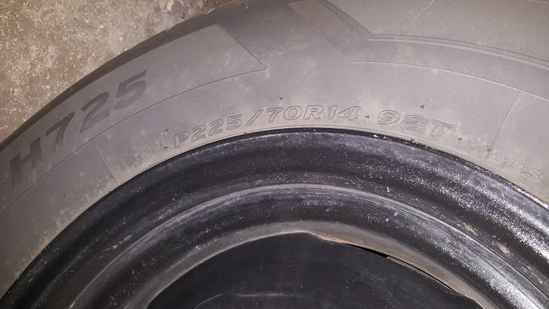

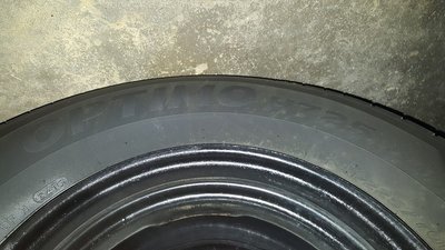

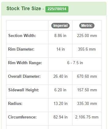

I'm running new Hankook Optimo H725 225/70R14 on my '73 Charger. No issues so far, seem to be decent tires for cruising. Width is 8 7/8 and Diameter (outer) is 26.4".
Previous owner had 235 14s on her, and the fronts were scraping on the inside. I didn't want to spacer them out, so went with these.
225-70R14 vs 235-75R15 - Tire and Wheel Plus Sizing _ Tire Size Calculator.jpg

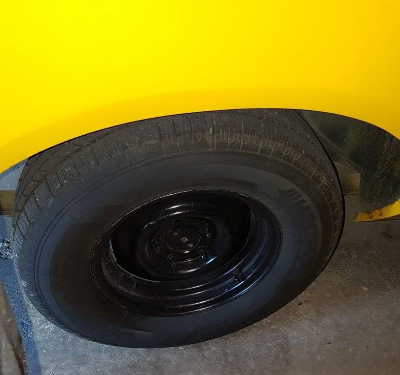

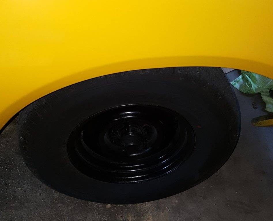

Going to get it figured out tomorrow morning.Went to the salvage yard got a 225/215/205 70 series tires,mounted them up on my rally's. Going to play Roadrunner dress up!!
