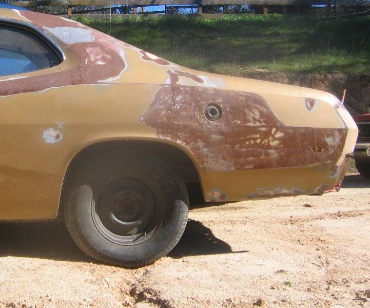

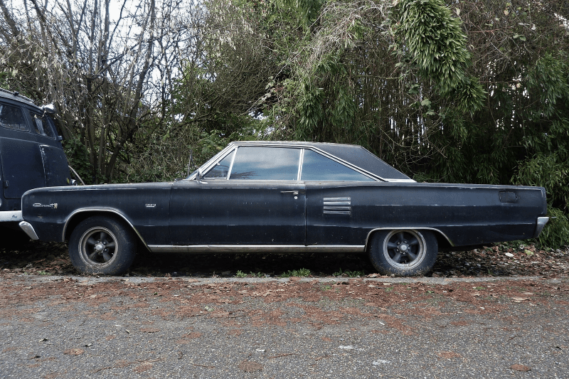

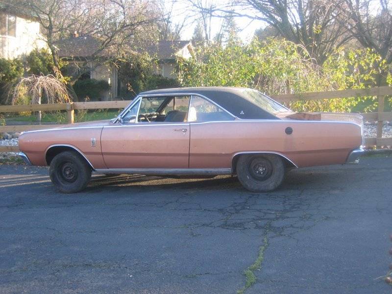

The 66-67 model cars did not have the higher arch wheel openings that the 68-70 cars had. The top 1/4 of the tire and wheel are covered by the lower hanging wheel opening, similar to the standard Dart versus Duster design:
Coronet:
68-70 Charger:
