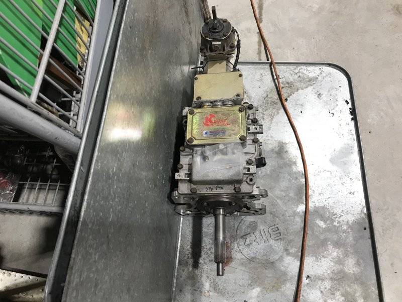

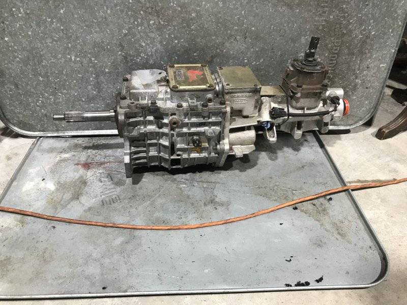

Can you get pictures of the trans & shifter? It would be better to know what your getting before committing...
I think that he’s keeping the shifter as he is changing to a TKS transmission. And I will get some pictures of it soon.

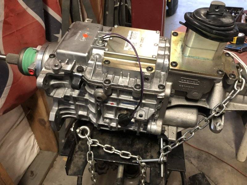

The TKO for a 66-70 B looks like this:
You can see that it has a cut in the top pf the case between the shifter and the end of the transmission, This is to clear the torsion bar crossmember.
The TKX is similar.

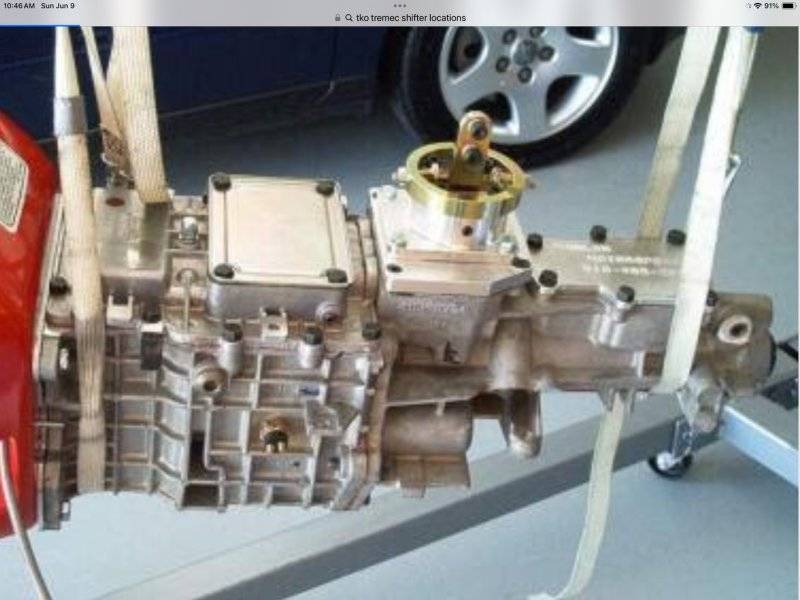

That is not a TKO.... It's a TR3550... The shape of the rear shifter location changed when they redesigned the TR3550 and renamed it TKO
TKO Shifter
TR3550 Shifter..
Nothing wrong with a TR3550 but it's rated at 375 Ft/Lbs of torque where the TKO is either 500 or 600
Also the pictures show two shifter locations... You would need the forward location... And the rear location needs to be machined away to clear the torsion bar crossmember...

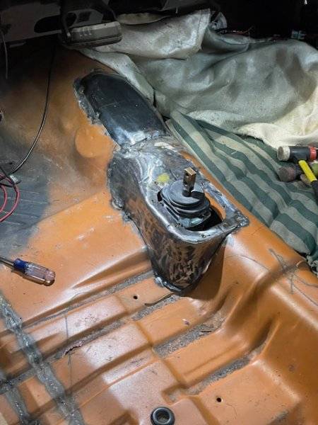

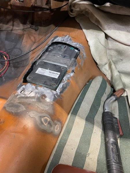

I somewhat recently installed a TKX in a 71 Charger and an E body TKX into a 70 Roadrunner (shifter in front of the torsion bar cross member).
The install in the 71 was easy and without drama, shifter landed where it was supposed to.
The install on the 70 did require some floor and cross member surgery. This is probably more of a function of the motor mounts that we used (572 Hemi with Tin Man mounts) as it positioned the engine/trans slightly high.
