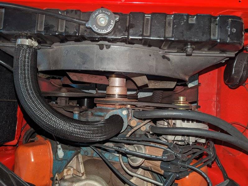

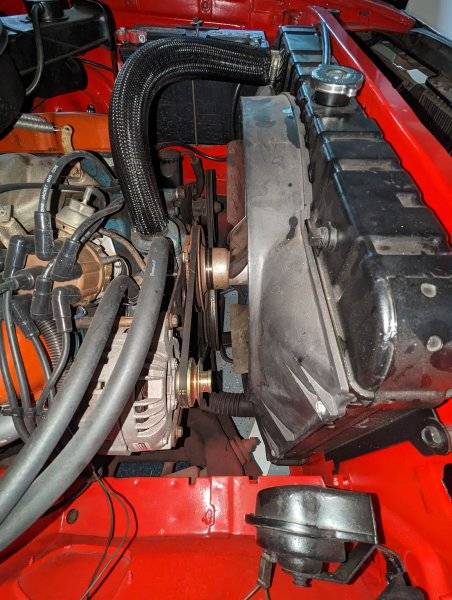

Your alt belt looks mis-aligned

Check the other belt, not sure but appears to be running against the fan spacer..

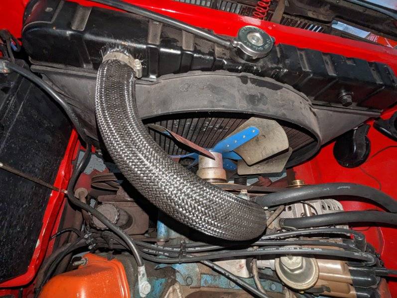

My top hose from the thermostat is on drivers side and the water pump connection is on my passenger side as shown in the pictures below. The top braided hose goes to the thermostate where at the very bottom you can see a corrigated hose which connects from the water hose to the engine block.
FYI my engine block is stamped Oct 1972.
Is this port arrangement standard for 70 Charger 440?'
Your top hose is the "universal" type as well.
That's just a covering to make it look better.
NO the port arrangement is opposite of what you usually see.
If it were me I'd get a water pump housing with the standard port layout and a radiator to match.
You still might have to spend some time and effort to get your pulley arrangement aligned but it's kind of a mismatch right now.
Hopefully you get something that works better in the end.
Thank you . The belt around the alternator does look not perfectly alighned. It does not appear that the belt is rubbing against anything . Don't know where the fan spacer is.

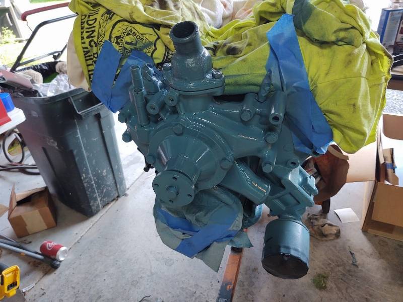

Thanks Don. But what is the standard layout? The engine block says Oct 1972. From what I see, the water enter the bottom of the block from the passenger side. The water pump out is also on the passenger side. I hear what you are saying, but I don't know how getting a water pump supplying the drivers side would help me.
This is the Mancini aluminum water pump housing, pump, bolts and you can get the heater hose nipples as well from them.
Then you can likely buy hoses for a 70 with a 440 from RockAuto or any parts store.
You might still need to work on the alignment of your alternator but maybe it will be correct after changing the housing?
Don't know about that one.
It's the fan pully - see a black strip around it where the belt looks to be contacting it - that belt looks glazed. Mal-aligned belts affect engine efficiency and pre-mature wear on those parts water pump/bearings, etc. MO, I'd repair those.
Thank you Ron, I see the black marks. I will let the mechanice know. It does not hit it at idle and don't hear when driving so not sure if the belt was lose when it was owned by the priort owner or not.

Thank you . I see the water pump actually discharges on the drivers side. I attached a better picture showing my water [corrogated] hose. Since it is corrogated, my hunch tells me that it might not be a standard hose but a generic hose to be able to contort to fit any size.

Maybe already posted; the lower hose looks cramped and not a great type of hose, MO. It can restrict coolant flow and possibly collapse more when hot. I'd suggest getting a pre-formed one for the setup.
