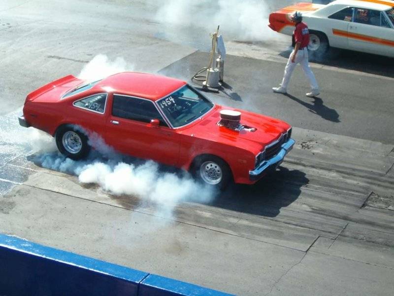

E85 and run it. 9.7 with E85 works well. We run turbo non intercooler at 9.6-1. Been as high as 21psi. Roots blower probably wouldnt be happy at 21 but 10-12psi would most likely work pretty easy. The other think mentioned was water/meth injector which definitely helps. As far as eye candy? I have a roots boosted iron headed 340 with .550 cam. 3885 race weight. 11.0@122 in street trim.
