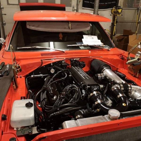

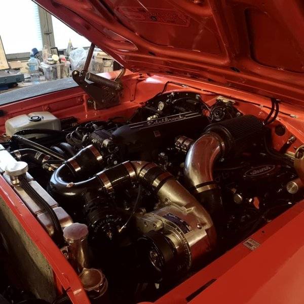

Hi i have a procharged 440 (505) w edelbrock pro Flo intake but use holley hp efi on this and its real fun when the bypass valve is closing and boost is loading

Hi i have a procharged 440 (505) w edelbrock pro Flo intake but use holley hp efi on this and its real fun when the bypass valve is closing and boost is loadingView attachment 925300 View attachment 925301
That is an awesome setup! Just curious, what is your static compression ratio? How much boost are you pushing? What type of fuel are you using? I see you aren't running an intercooler, so I guess you are running water/meth injection? Any idea about the power output?

That is a good point. I could change the gaskets to get better quench (the .028 you mentioned would raise my compression from 9.7 to 9.9 and give me .046 quench) but open the chambers 5cc that you mentioned would bring the compression back down to 9.52 even with the thinner gaskets. I hadn't considered opening up the chambers.
Sorry to bombard you with questions, I'm just really curious what is working for others. Thanks.
Hi i have build this first AS a 446 w eagle crank and rods and 9.2 je piston w edelbrock rpm heads and a mild crane cam 2 stage water/meth kit. 95 oqtane and 14psi boost was 588hp at the tire.. But because of a bad first gen holley dual sync distributor i destroy the ringland on the je pistons. So now the same block w molnar-technologies crank and rods custom CP 9:1 pistons 505 cid. bullet cam and trickflow 240 heads and harland sharp roller rocker. And holley hp efi w water meth kit. I dont have IT on a Dyno yet but this combo work god and have way more power... I also use a ptc 10.5 converter 3200 stall cope 727 race5 and gearvendor to a moser Dana 60 3.73.
