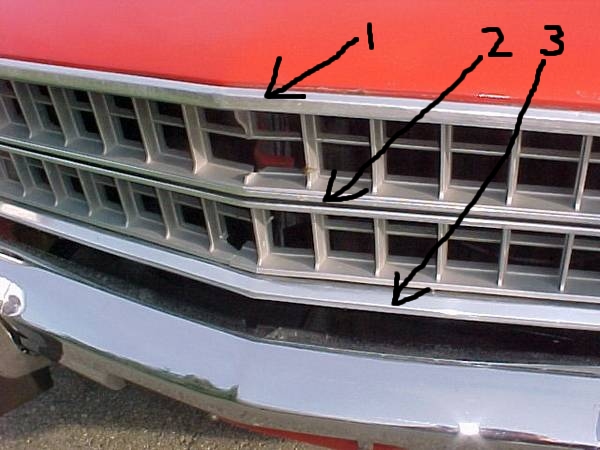

There is also a middle piece with a painted black stripe in the center and a top piece. All three are attached to the grill by screws just like the bottom one. Here is a pic of them on my car in their original beat-up condition when I bought it.

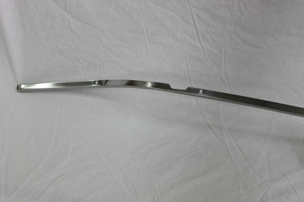

And here is an underside view of the top one after stripping the anodize and repolishing and buffing.
These grill trim pieces come up for sale on ebay every so often - either by themselves or as attached to a grill. Just set up alerts for road runner, roadrunner, and satellite grills. I just missed a pretty badly broken satellite grill. It had decent trims though.

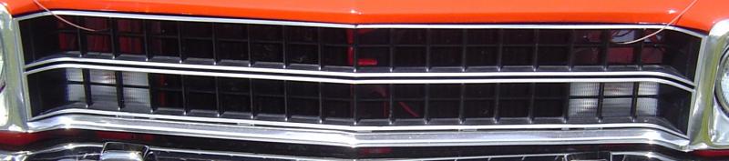

Interesting, your grill is grey, typically what is seen on Satellites, and only the second example I have ever seen with those trim pieces. For a roadrunner, I believe the correct grill is as shown below.
You are correct that the Road Runner grill is originally black. I have one of those in the basement. Every so often I put in on my car - but invariably I switch back to the silver one. It just seems to go with the other brightwork in front and looks better to me. The same with the engine and paint. This was originally a 318 FE5 Rallye Red car. I just like the 440 and the Inferno Red better.
I've been hoping to find another decent or repairable grill. I want to try a hybrid - black inside the grates with all the leading edges silver.
