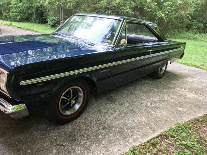

just got my belvedere it has headers and some kind of turbo mufflers.it needs to let the cam talk (lol) a little ,any advice.
Thanks roby

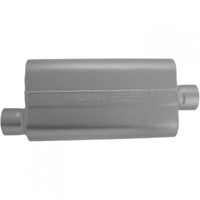

Flowmaster 50-Series Delta-flow
full mandrel bent 3" with an H-pipe Musclecar system
all the way out the rear

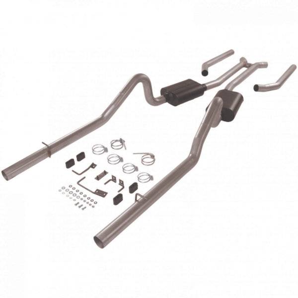

a bit tamer sounding than the 40's series
it's sort of loud but not obnoxious

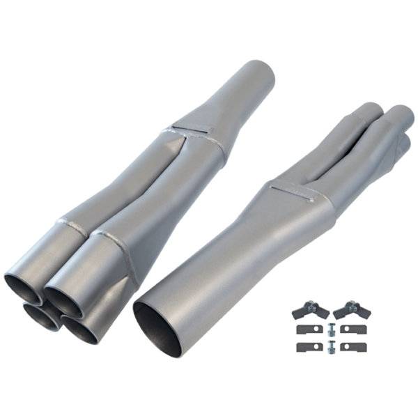

I like a muscle car to have it's pipes, be heard
if you don't like the tone, than leave it alone

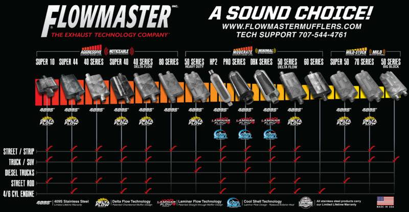

I don't notice a drone really,
but I've has some sort of Flowmaster's for decades now
I have a Flowmaster system on both my trucks too
depending on what size pipe,
a moderate mod.'s a 2-1/4" to 2-1/2" pipes are plenty
if your making better power, maybe the 3" (or larger) is for you
too big of pipe when you don't have enough power to justify it
will help to cause reverb & air/exhaust to stall making that 'drone' tone
