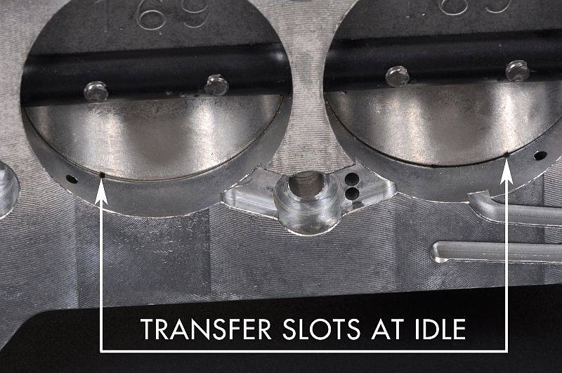

Check your idle transfer slot location too to make sure it isn't running off the idle circuit ad the main fuel circuit too. You want them set so they are square visually like below. Yes adjust both float bowls to ensure fuel isn't flooding the carb at idle.
