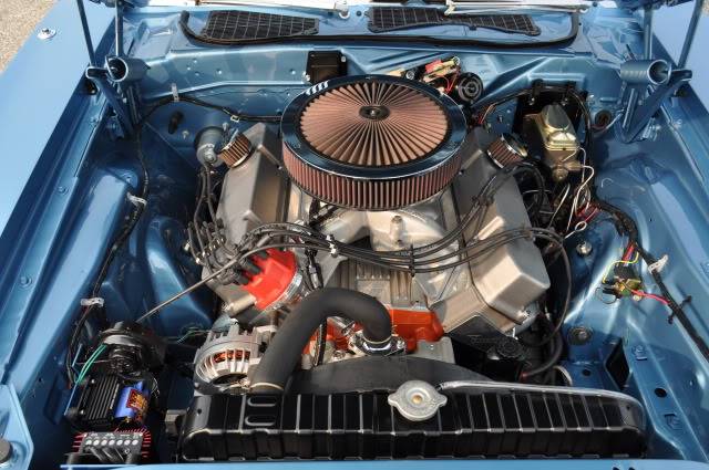

I used the RPM on the stroker in my Cuda mainly for hood clearance. I could have got more ponies using a different (and taller)manifold, but I did not want to cut a hole in my hood.
