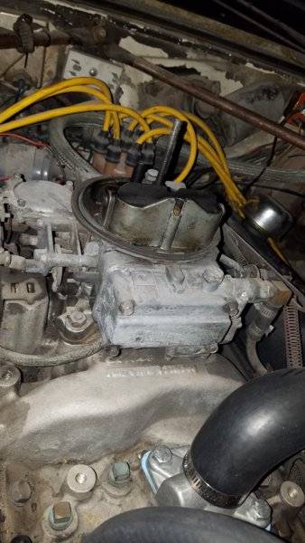

Engine size and the modifications made: I say you 360cid 5.9L. Edelbrock manifold, I think the marking say Edelbrock "Performer 318/360". All I can get off the carb is "Holley" I can't see anything else till after I clean the damn thing.

If you can’t figure out what intake it is, snap a shot and post it up! We will tell you what it is and anything else you may need to know!

Edelbrock manifold, I think the marking say Edelbrock "Performer 318/360". All I can get off the carb is "Holley" I can't see anything else till after I clean the thing at least.

On the carbs air horn are numbers starting with the word “list.”

Im scared of going 75+ in this bucket LoL. So much suspension stuff to fix on it eventually I hope to tame it. It's an LA 360 from a 74 Imperial supposedly. I'm not sure if it was originally a 4BBL or a 2BBL. The A/C was stripped. I'll check out those digits on the rear end and carb. Thanks man.
