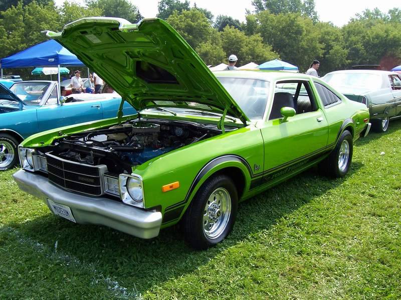

How did you find a 1976 Aspen in Germany? I say you should have built the ultimate sleeper - Hemi Trabant.
I met an American that lived there and he had it in his shop for many years. He was going to rebuild it, but you know how that works. Here is how it looked when I sold it.
