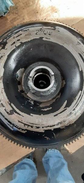

........... The fella who rebuilt my 727 suggested I purchase a new converter while going through all the work of rebuilding the trans. The one I had was working fine. There is a 2709 and a 1096 stamped into it but not sure if that has any value to identifying it. Reuse it?

Just Googling it looks like the 2709 is a 11" converter that Summit sells.

.............. The fella who rebuilt my 727 suggested I purchase a new converter while going through all the work of rebuilding the trans. The one I had was working fine. There is a 2709 and a 1096 stamped into it but not sure if that has any value to identifying it. Reuse it?
If the trans was not burned up before rebuilding and fluid was decent looking I recommend reuse. I've done it dozens of times in my rebuilds. A Torque Flite will operate with lots of dirt (not that it's desirable) compared to a Ford or GM tranny.

No problem reusing the used factory 12" if if you liked the performance. A high stall 11" factory converter would wake it up.

Hello Packfan, As you found out, that converter is a Summit tc. part # SUM-G2709. If you read the reviews you know that they were unfavorable to this TC. Yours maybe working ok but not performing at a very high level. I suspect that mine is also in that category although I don't know anything about it except that it's painted blue and I'm not satisfied with the low end performance of my 383. Yes many other factors are at play and I've addressed several of them. If your engine builder suggested to change the TC, than ask why. I've been trying to gain some knowledge about TCs in general and have decided that if a converter IS what I need then I've made up my mind a get a Hughes performance 24-25 unit. Not recommending that you do anything at all, just saying where I'm at on this topic. Good Luck
Thanks for the great feedback fellas. I agree with you Ray, the feedback is not good on my Summit TC and I only drove the car a mile after buying it because the engine would not run worth a dang (was a 383). I am going to call Precision tomorrow and see what they think. Man, the price on these things!

.................The fella who rebuilt my 727 suggested I purchase a new converter while going through all the work of rebuilding the trans. The one I had was working fine. There is a 2709 and a 1096 stamped into it but not sure if that has any value to identifying it. Reuse it?
Stick a screwdriver in it and check one way clutch to make sure it is not
broke and goes backwards. Flush it out and make sure nothing is in pieces
with a strainer. 99 times out of 100 it will be fine. I have not seen a NOS
stock convertor in 40 years = All my converters are built out of used cores
that we replace the internals.
The 10 3/4 converter would make a huge difference over the 11 3/4.
Look for one that has a smooth cover (340 original) and it will stall 300
higher that one with a flat area on to (383/Hemi).
Count the splines as they changed the count in the 67 model year up to 24.
Early one will not fit front pump.
The converter in picture appears to be 11 3/4.
Almost every big town out out here has a converter
rebuilder. Should cost $100. to 150. at most to go thru.
