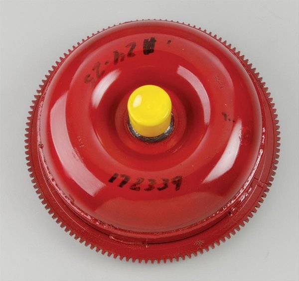

Try this BeeKool...
https://www.summitracing.com/parts/...MIu6aDgpiL2QIVFbbACh39nQpoEAQYASABEgKbBfD_BwE
Definitely DON'T install a converter that has dirt in it!!
