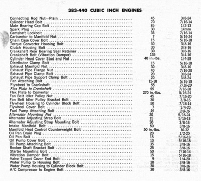

this chart may help some,
I'd go by the bolt size, if in doubt
Budnicks, Thanks for the chart but that pertains to the cast iron. Is it different when bolting into aluminum?
Cranky...Thanks, that's exactly what I was looking for!
