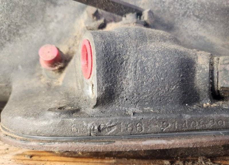

I have a 727 that’s been in the garage for 27 years and had bought it with a bunch of other parts, including a ‘65 Coronet rear I installed soon after I got it in my ‘63. The guy I bought it from seemed like a walking early mopar encyclopedia saying this trans was a ’65 out of the same car. Having mentioned it in another post got a message from a fellow member asking more about it.
Had trouble reading the numbers; but think I have most of them: Appears to be 66 214 062 (might be another digit at the end as a 9 or 0, not sure). Looking at the charts I could find, didn't find any further back then ’65. No numbers correspond. My next guess is I may have a ’62-’64. It’s cable setup and aluminum case.

Your numbers are missing digits
does it take a slip yoke or have a flange and the output end?
A 65 trans will be cable shift with a slip yoke. It is a one year configuration. You are missing some numbers. The 65 numbers that I have all start with 24661, and a 318 -727 is 2466166. There is also a seven digit number after the part number if it is pre 68.
I'm looking more at the numbers using a mag-glass and camera, seems a section has been indented messing one or two up. I also see a G ahead of the digits and 166 214 062 - final digit is offset which could be a 0 or 9. Well, I'll see if I can detect more on the numbers. Given what I find so far, sure doesn't comport with '65 #'s. Thanks
Read post number 3 again to determine if it is a 65. How far to the left of the 166 is the G?

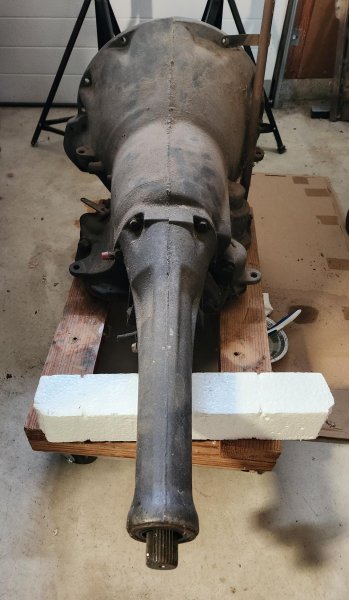

It is good half inch, seems like the dent has damaged numbering after the G. The tail is a bare spline. I'll stare at the numbers more maybe get lucky.
Any aware of numbers for 62-64 transmissions? I haven't come across any.

Maybe a pic of the pan rail on the one you are working on may help??

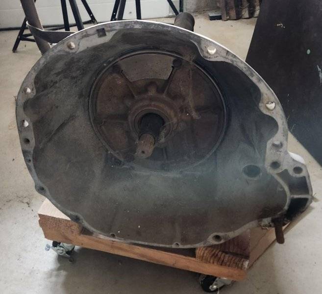

If the tailshaft is a straight spline, it is a '65 transmission. If there is a threaded extension for a bolt on flange, it is a '62-'64 piece.
I'll put up some photos thanks.

The picture of the numbers does look to me like it’s probably 2466166. Small block 65 transmission.
