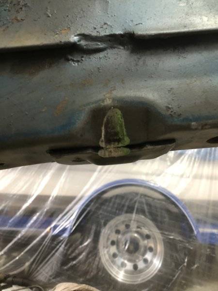

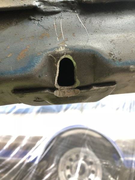

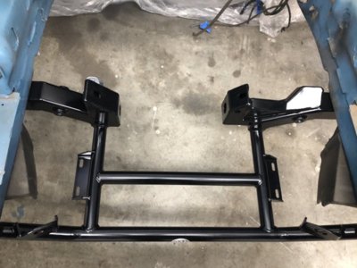

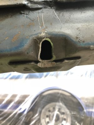

is this common? I didn’t notice until I tore apart the front end and was cleaning everything. Looks like the torsion bar adjuster was rubbing on the frame for a while. I checked the old parts and there is tons of play in the bushings. I guess it was enough to make it rub. Worried something was bent, I grabbed my new k frame and lower control arms, threw them In and they clear on both sides by about an 1/8”. It just seems like dodge could have left a little more room. I cut a hole in the worn area and will patch tomorrow.

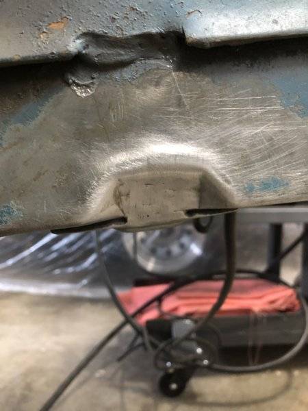

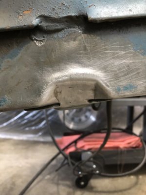

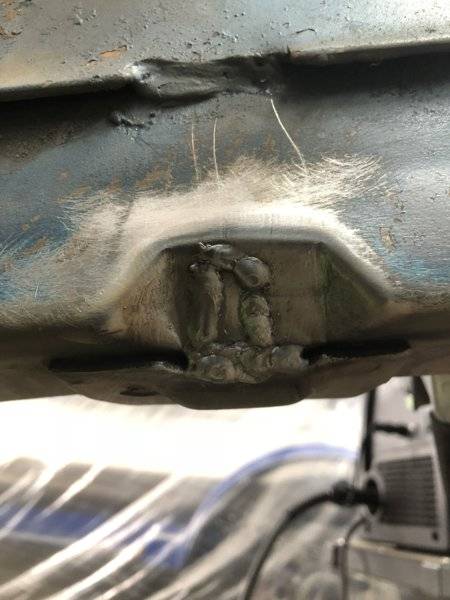

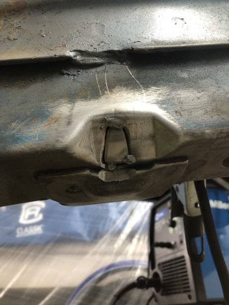

Well I ended up just patching the frame up. It was going to bug me until I patched it.
